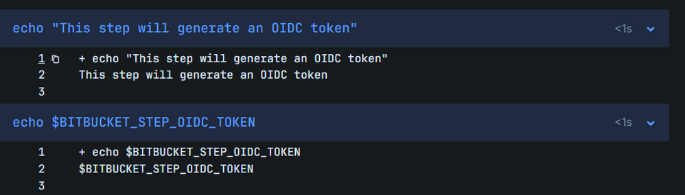

I was trying to connect bitbucket pipeline with GCP vm instance and could not do it.
On series of debugging when I tried accessing the token using simple pipeline and still couldn't find out why token is not populated
Below is my simple pipeline :
pipelines:
  default:
    - step:
        oidc: true
        script:
            - echo "This step will generate an OIDC token"
            - echo $BITBUCKET_STEP_OIDC_TOKEN # Access the token
Attaching the output from the pipeline
Does anyone know why token is not show ? What can be done to access this token ?

Hi Naveen,
The token is stored as a secured variable, which is why its value will not show in the build log. If a value matching a secured variable appears in the logs, Pipelines will replace it with $VARIABLE_NAME.
If you want to retrieve the variable's value, you can first store it in a file by adding a command in your yml file like this:
- echo $BITBUCKET_STEP_OIDC_TOKEN > oidc_token.txt
Then, one option is to upload this file to a server of yours. You'll need to add a command in your yml file to do that; the command depends on what the server supports e.g. ftp, or curl with an API, scp (you'd need to set up SSH access for scp https://support.atlassian.com/bitbucket-cloud/docs/using-ssh-keys-in-bitbucket-pipelines/).
Another option would be to define that file as an artifact in your yml file, then you should be able to download it from the Artifacts tab of the Pipelines build:
While this is easier to set up, please be mindful that artifacts can be downloaded by every user with read access to the repository.
Please feel free to reach out if you have any questions.
