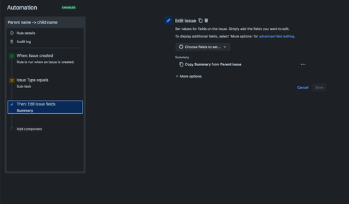

and its enabled, but it shows this error, please refer to the screenshot attached below

Is issue WEB-570 a sub-task? What happens is that the rule will fire every time an issue is created on that project (or all projects if it is a Global rule). So this is just information, not an error.

so my automation has started working on company managed projects, but it over ruling the existing sub task name, it should be parent name + subtask name.
How can I fix this?
John Funk
June 19, 2023
Well, if I am reading all of that right in what you have presented, the only Condition you are using checks if the Issue is a Sub-task. You said it is, but the Audit Log says it isn't - so there's a disconnect there somewhere.

So the Sub-task will get created as it is filled out.
So for Edit Issue Summary field, put in the code:
{{issue.parent.summary}} - {{issue.summary}}
