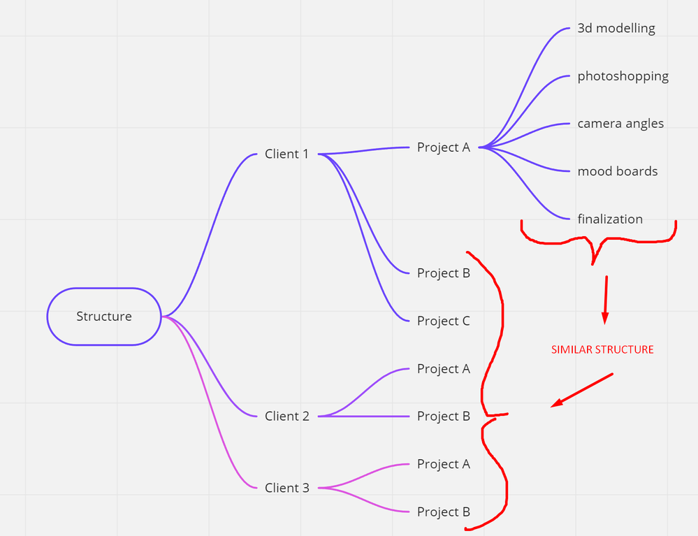

Our projects usually have a structure like this:
Which issues and hierarchy should we use? More people work on this project at one time and because just one assignee is necessary to create sub-issues I guess.

@Callum Carlile _Automation Consultants_ Thank you for your answer. Do you have idea which issue structure we should use if we decide to go with Jira software? I am not sure if what I drew in original post is good for us.
Thanks also for tip to Rodney Nissen, I've read his article and it's helpful for decision which version of Jira use.
@Michal Bergmann I think your structure will look very similar to what you have drawn - your 3 clients could all be on the same instance of Jira (unless they require separate instances, or you hadn't planned for them all to be on the same instance?), then you could create 3 separate projects in Jira. You could then create your 5 new issue types (3D modelling, photoshopping etc.) and create a new issue type scheme and add these new issue types to it. You'd then associate this same issue type scheme to your 3 projects.
Depending on your requirements, you then may want to create some separate permission schemes if you only want the clients to see the projects that they are linked to in the above diagram (e.g. projects A and B could share the same permission scheme as all the clients have access to this but you might need to have project C on a different scheme if you only want Client 1 to have access it).
I would also recommend creating your projects as company-managed projects rather than team-managed projects, as you will be able to re-use the issue type and permission schemes

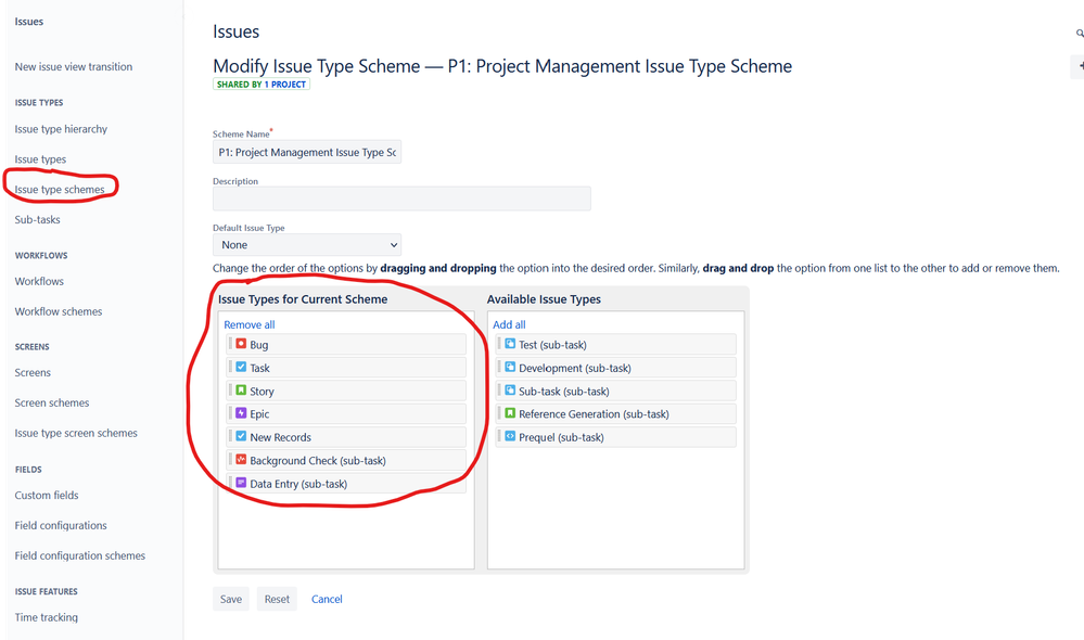

@Michal Bergmann here's an example screenshot:
I found this by going to the Admin Settings > Issues > Issue Type Schemes, then clicked to edit the one associated to my project. Here you can drag and drop your available issue types from the right to the left.
So if you need to create new issue types to add to this scheme, go to Admin Settings > Issues > Issue Types.
Note that this setup is what you would do for company-managed projects, and you don't use these schemes for team-managed projects.
If you're using the free version then you will be able to do the above. You will also be able to create a permission scheme and associate it with a project, but you're unable to add users to specific project roles in project settings - so you would need to use application access/groups when assigning groups of people to permissions in your permission scheme
