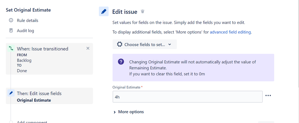

I have setup an automation rule that updates field
"Original Estimate" based on the ticket type.
In the automation, it specifically states that
"Changing Original Estimate will not automatically adjust the value of Remaining Estimate."
But this does not seem to be the case.

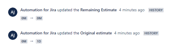

Automation sets "Original Estimate" correctly based on the rules, but then for unknow reason sets the "Remaining Estimate" to 0m
2022-09-05 11_32_58-Automation - JIRA.png 2022-09-05 11_33_19-[SALES-55] Issue integration - JIRA - results.png

From the tests I've made on my instance here are my results:
  • When entering original estimate for the first time, while remaining estimate was null then indeed the automation was setting the remaining estimate to 0.
  • When I logged in time and then set the original estimate again, then the remaining estimate was not changed.
Now since these two fields are connected to each other, I believe that this was made on purpose. Remaining estimate is set to 0, in order to be unchangeable by your change on original estimate.

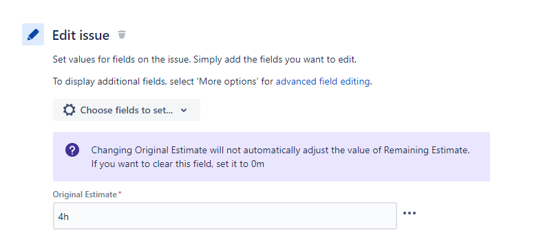

As per the screenshot, it seems that some issue in Automation rule. You are trying to set 4h Original estimate but automation is setting it 1D , is it correct ?

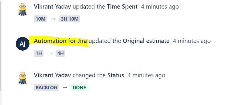

Remaining estimate is calculate automatically based on Time Spent on issue, yeah it's possible to set manually, but usually Remaining estimate calculated based on Time Spent field.
Check if any other rule in the project which is setting Remaining Estimate ?
If you selected only Original Estimate then Automation set only Original Estimate.
