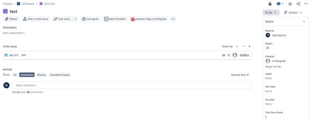

I have tried a lot of different ways to sum up the total story points to an epic based on previous questions and resolutions however unfortunately I'm still missing something and can't get my totals to add up in the epic.
I have set the following rules for automation:

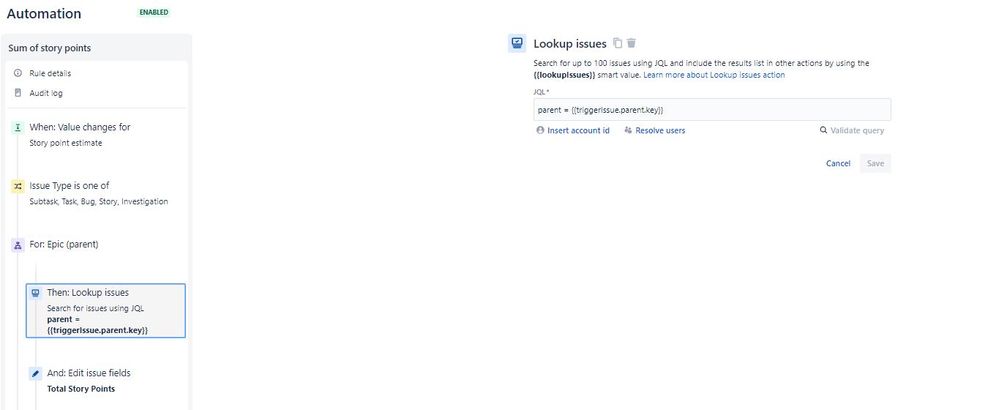

The automation rule says that everything has passed however the sum of the story points are not being updated in the epic:
Hoping someone can help point me in the right direction. Thanks

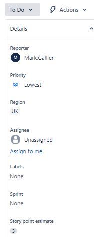

The value for the "Story point estimate" field in the trigger issue is "3":

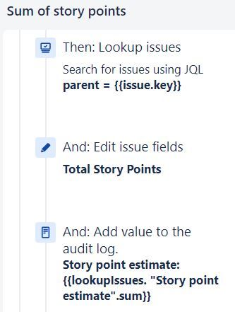

This is the smart value from the "Total Story Points" field:
{{lookupIssues."Story point estimate".sum}}
I can't see anything about "Log action" unfortunately to give that a go.
Let me know if you need anything else. Thanks

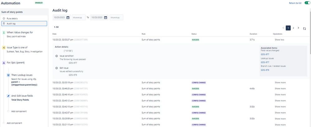

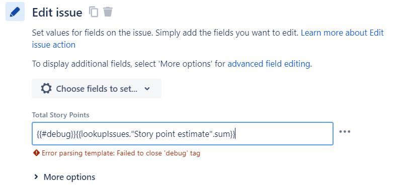

I've tried adding the {{#debug}} to help test my smart value rule but it doesn't appear to be working so I'm still a bit stuck - is there anything else I can do here please?
Trudy P Claspill
October 25, 2023

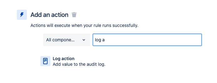

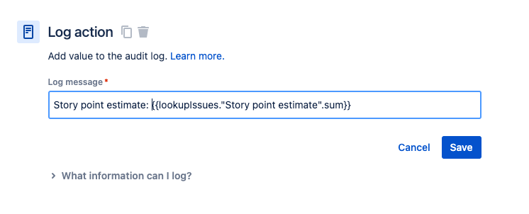

You don't need "{{#debug}}".
Use the Log action to print out the smart value to the Audit Log when the rule executes.
You can add some explicit text so that you recognize the output in the log.
Screenshot 2023-10-25 at 5.56.12 PM.pngScreenshot 2023-10-25 at 5.56.28 PM.png

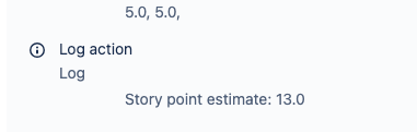

The output in the log would then look something like this.

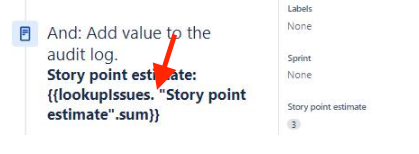

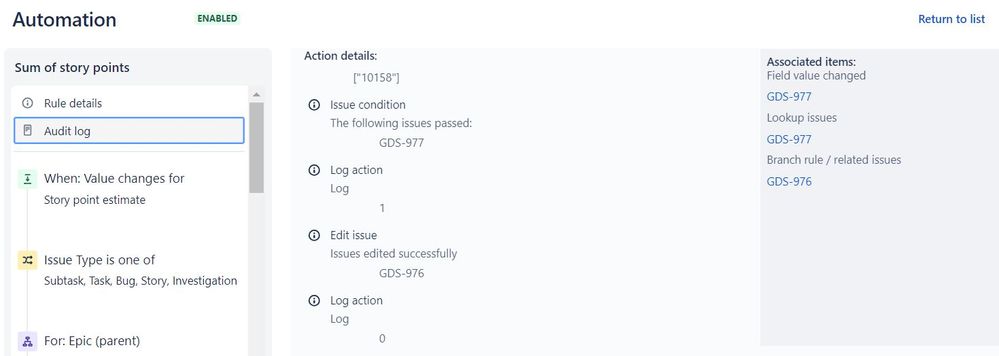

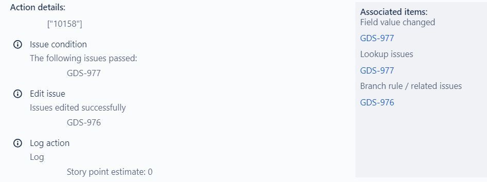

The log is working however I still can't work out why it's calculating as 0 when I change the "Story point estimate" field on the ticket
What's strange is I have the automation set up on other Team Managed projects and it works correctly so I'm not sure what the difference is here. Hoping you can help. Thanks

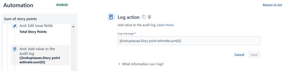

Bill Sheboy
October 26, 2023
Looking at that latest screen image, I wonder if the smart value expression you are using is invalid.  Smart values are name, spacing, and case-sensitive.
Please try using exactly this one, with no changes.  I added a default value of 0 in the event the field is empty.
{{lookupIssues.Story point estimate.sum|0}}
And can you confirm that the issue shown in the log, GDS-977, actually has a value in the field?

As Bill said, smart values need to be exactly right. In your Log action for the Lookup Issues sum, it looks like you might have a blank space in the smart value.

Thanks for your further support and recommendations. I've carried out both of your suggestions and unfortunately it's still not working. It picks up the issue in the logs but it's still not picking up the story point estimate from the relevant field. The field itself is a Jira default field - the only customer created field I have made is the Total Story Points field under the epic issue type.
it should show 3 story points based on the change above from ticket 977 but it's just pulling through as a 0. Any other suggestions at all please?

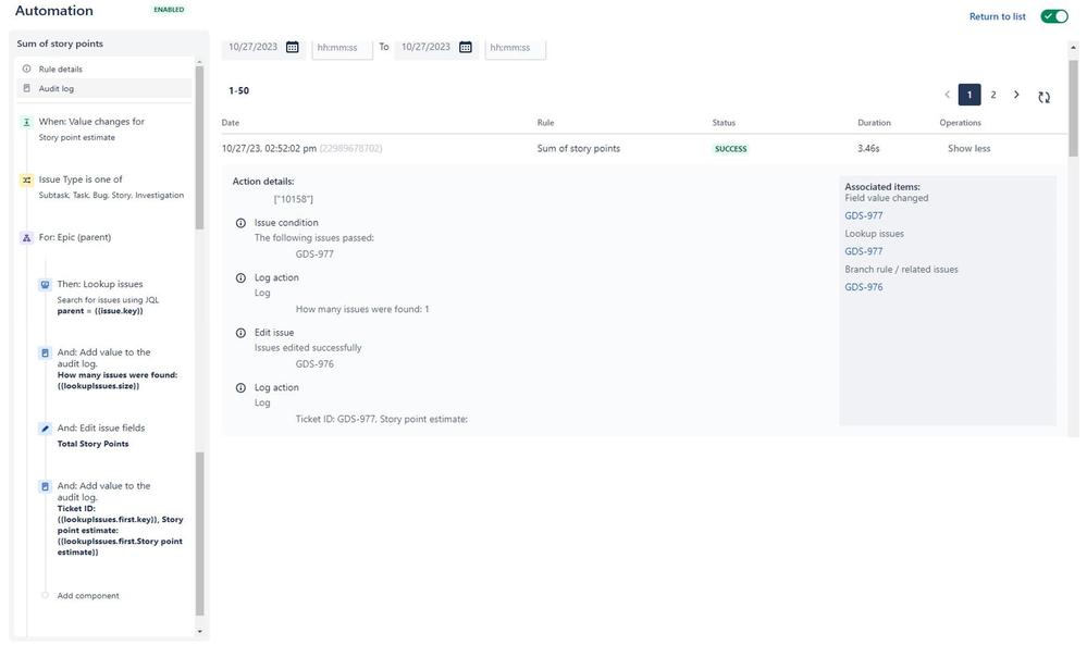

Mark_Gallier
October 27, 2023
Hi @Trudy P Claspill @Bill Sheboy

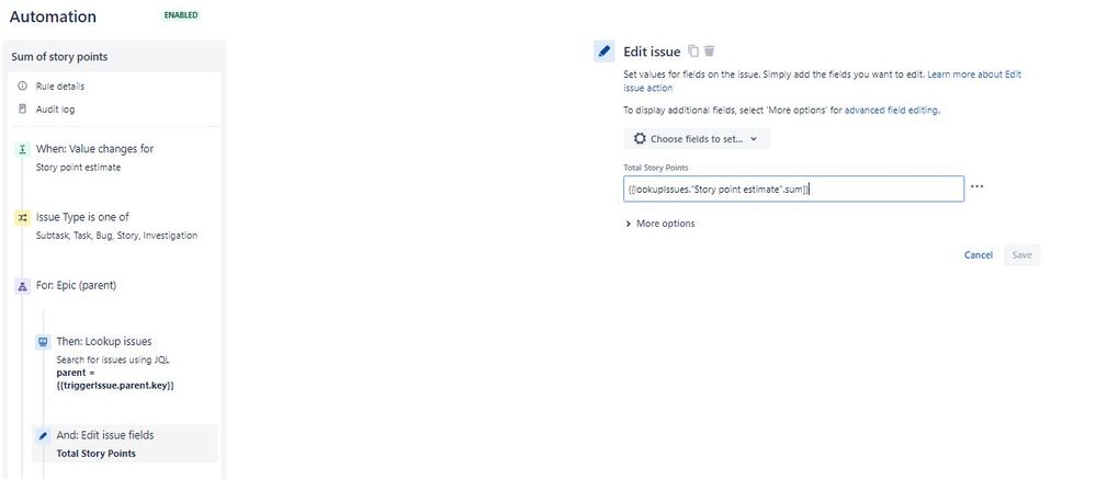

I've made further changes as you've suggested and it does look like there's something wrong with the 'Story point estimate' field as the rule just doesn't appear to be picking any data up in that. Here's a screenshot of the rule in it's entirety:
As mentioned previously the 'Story point estimate' is the Jira default field so I'm not sure why this isn't working. Any other help would be really grateful so I can get to the bottom of this issue please. Thanks
