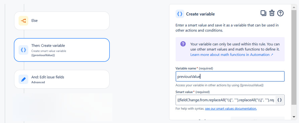

  2. Create a variable.
    1. Name it whatever you'd like. I'm using 'previousValue' as my example.
    2. For the 'Smart value' field, use this to parse the multiselect values:
      1. {{fieldChange.from.replaceAll("\\[", "").replaceAll("\\]", "").replaceAll("\\s*,\\s*", ",").replaceAll("([^,]+)", "{\"id\":\"$1\"}")}}

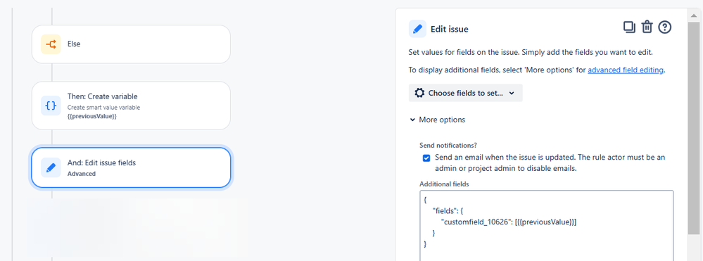

  3. Edit issue fields.
    1. In the 'Additional fields' section, paste what's below:
      1. {
        "fields": {
        "customfield_XXXXX": [{{previousValue}}]
      2. Replace 'XXXXX' with your field ID.
      3. Replace the 'previousValue' text with whatever variable name you chose in the previous step (leave all the brackets in place).
This should successfully revert your custom multiselect field back to the previously selected value(s). Depending on the value options you have in your field, you may have to adjust 2.2.1 above to account for text variances. Here's are screenshots of the rule in case it's helpful (irrelevant components are blurred out):
