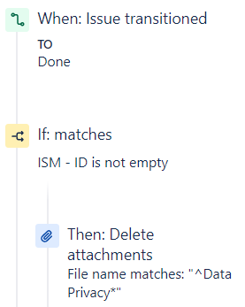

Hope somebody can help as I am struggling to get an automation to work. It's not a particularly tricky one; when an issue transitions to done, if a certain field is not empty, delete all attachments that start with the string "Data Privacy".
Automation triggers fine, if condition matches but the attachments are not deleted.
I've tried variations of the regex as I am not a regex master by any stretch but online tools suggest they would all work:
  • "^Data Privacy*"
  • "Data Privacy*"
  • Data Privacy*
  • Data*

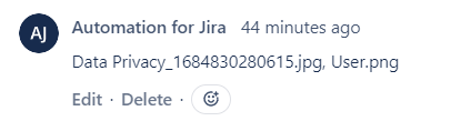

I've output the names of the attachments in a comment using another Jira automation to try and prove that the automation is seeing the filenames as I see them:

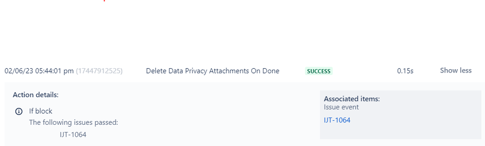

Here's the audit log of the last run:

My guess it that the regex for the file name needs to match the whole name, so try using this one and see if it works:
Data Privacy.*
adam.carter
June 5, 2023
That did it, thank you Mikael!!

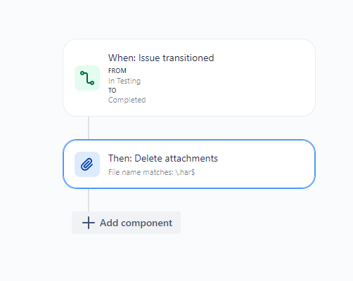

@Mikael Sandberg looking to do something similar where we automatically delete .har files on ticket resolution in response to Hackers Stole Access Tokens from Okta’s Support Unit – Krebs on Security
Also not a regex expert ... but our expectation was that this would work: \.har$
Like • Julia @ 55 Degrees likes this
Mikael Sandberg
November 1, 2023
@Jeremy Drexler It looks like the delete attachment step is not converting the $ regex correctly. I just tested and .*.har seems to work.
Jeremy Drexler
November 2, 2023
It does! Thanks Mikael!
