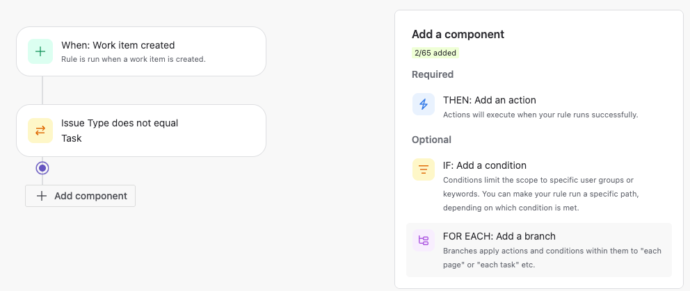

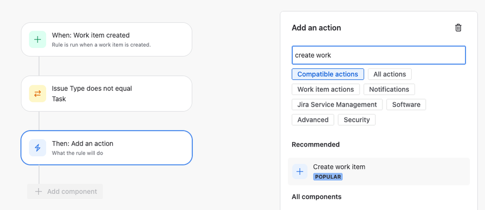

Trudy P Claspill
May 1, 2025
Hello @suzanne.moss
If you are new to Jira I recommend that you visit the Learning area (link at the top of the Community pages) to find the free, on-demand training courses available for Jira products. The have courses for different knowledge levels (i.e. beginner) and a variety of topics, include Automation Rules.
There is no action named "THEN".

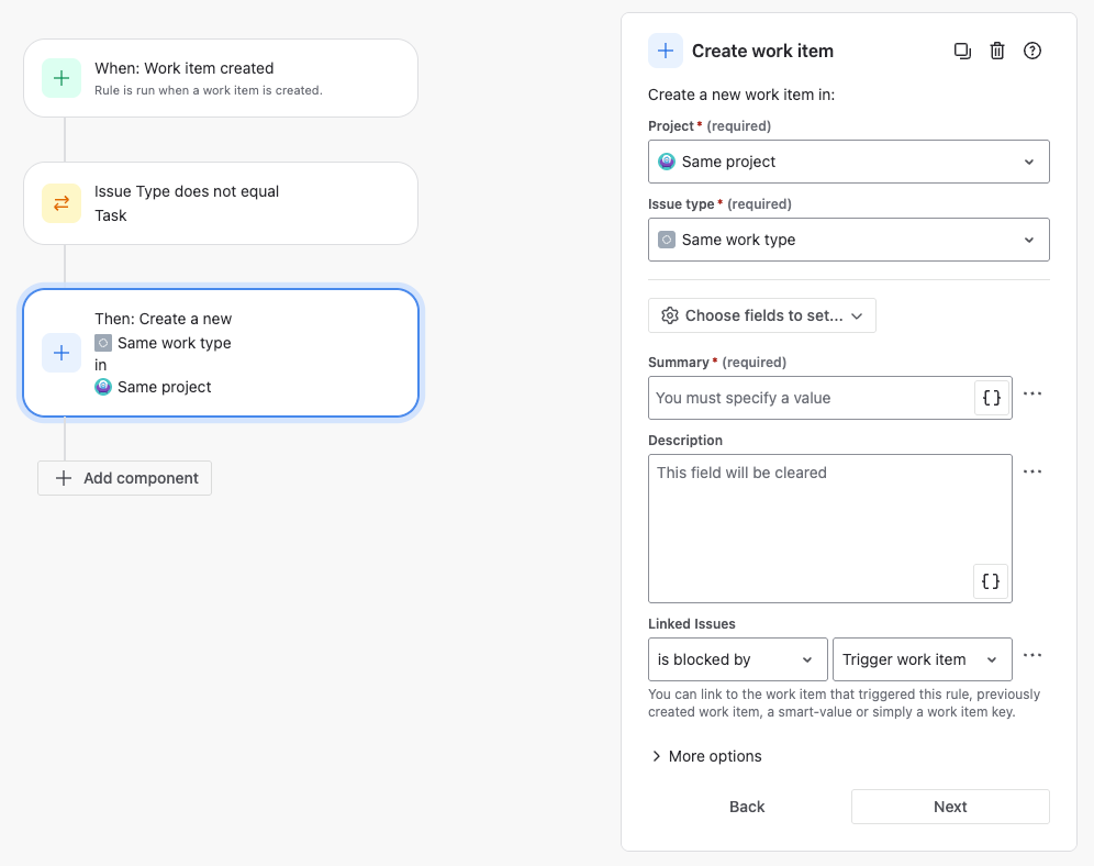

You simply add the actions after the 'IF'. The "then" is implied.Screenshot 2025-05-01 at 7.37.24 AM.pngScreenshot 2025-05-01 at 7.37.45 AM.pngScreenshot 2025-05-01 at 7.38.05 AM.png
You will need to add the Linked Issues field in your Create Work Item action to create a link between the new issue and the issue that triggered the rule.
Screenshot 2025-05-01 at 7.39.02 AM.pngScreenshot 2025-05-01 at 7.40.03 AM.png
