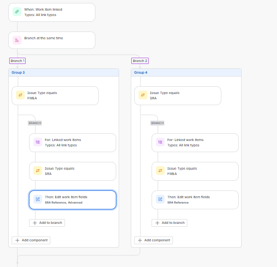

I am attempting to update a custom field available on the FMEA work type using data sourced from a linked SRA work type within the same Jira project. The goal is to have a single automation rule that functions correctly regardless of which issue type the link is created from.
Current Automation Configuration
The automation is triggered when a work item is linked, and it is structured with two separate branches to handle both possible link directions.
Branch 1: Trigger Issue is FMEA
  • The automation first checks whether the triggering issue type is FMEA
  • A branch for linked work items is created
  • Within that branch, a condition verifies that the linked issue type is SRA
    (At this point, the SRA becomes the current issue context)
Intended behavior:
Use a field value from the SRA issue to update a custom field on the destination issue (FMEA).
Issue encountered:
I am unable to update the FMEA issue from this branch. The automation does not update the custom field on the triggering FMEA work item, even though the correct SRA issue is identified and its data is available.
Branch 2: Trigger Issue is SRA
  • The automation checks whether the triggering issue type is SRA
  • A linked work items branch is created
  • The linked issue is validated to be of type FMEA
  • The custom field is updated on the current issue, which at this point is the FMEA
This branch works as expected, since the automation directly updates the current issue (FMEA) using data from the trigger issue (SRA).
Core Challenge
The challenge arises in Branch 1, where:
  • The automation context switches to the linked SRA issue
  • However, the value needs to be written back to the original triggering issue (FMEA)
Because the current issue context inside the branch is SRA, the automation does not correctly update the destination (trigger) FMEA issue unless explicitly handled.

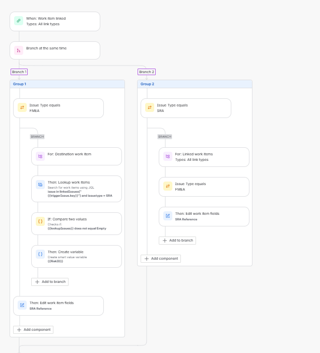

lakshyajeet_swami
March 31, 2026
What I did was created a lookup issue and then created a variable out of it to fetch the data from lookup issues then finally updated the field at destination, Please see below ss for reference.

lakshyajeet_swami
March 31, 2026
Hi @Arkadiusz Wroblewski ,
Thanks a lot for the prompt support But I believe I was able to resolve this issue own my own.

lakshyajeet_swami
March 31, 2026
As shown in the screenshot below, Branch 1 is where changes are required for the automation to function correctly.
In this branch, the automation workflow is structured as follows:
  • The rule is triggered when a work item is linked
  • A condition confirms that the triggering work item is of type FMEA
  • A Linked Work Items branch is then created
  • Within this branch, a condition validates that the linked work item is of type SRA, which at this point becomes the current issue context
At this stage, the automation correctly identifies the linked SRA work item and has access to the required data field (e.g., Risk ID). However, the update action currently fails because the automation is operating within the SRA issue context, while the field that needs to be updated exists on the original triggering FMEA work item.
The expected behavior in Branch 1 is for the automation to:
  • Traverse back from the linked SRA issue
  • Reference the triggering issue (FMEA)
  • Update the custom field on the FMEA work item using values retrieved from the SRA
At present, this reverse update does not occur, as the automation attempts to update only the “current issue” (SRA) inside the linked-work-item branch.
