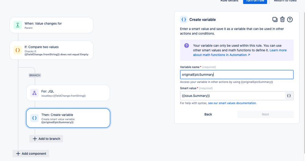

You might be able to use something like this to branch to the original parent epic issue and get the summary:
Note that if the content of your communications depends on both the original parent summary and the new parent summary, the steps related to examining those value and sending the message would need to occur within the branch. Branches and the steps within the branch run in parallel to steps that are at the same level where the branch split off, so steps added where the Add Component button is would be executing at the same time as the steps within the branch. Additionally a variable created within a branch will be unknown and undefined outside of that branch.
Alternately you might use the Lookup Issues action to retrieve the original parent Epic, and then reference the issue entity Summary using {{lookupIssues.first.Summary}}
I would recommend adding conditions also to ensure that the rule is triggered by a change on an issue type that may be a child of an Epic. The Parent field is also used in sub-tasks, and in Epics and issue hierarchy levels above Epic (if you have created those). So you can't assume that when this rule is triggered (as is) it was triggered by a change to a child of an Epic.

Thank you @Trudy P Claspill , that is a nicer way to get the from parent key than {{#changelog.epic link}}{{fromString}}{{/}}
The first step is a filter that rules out sub-tasks, and projects that aren't of interest to us:
key = {{issue.key}} AND issuetype in standardIssueTypes() AND category = "System Layer"
I'll now work through the lookup approach to find the parent's parent to focus the actions on the initiative of interest.
