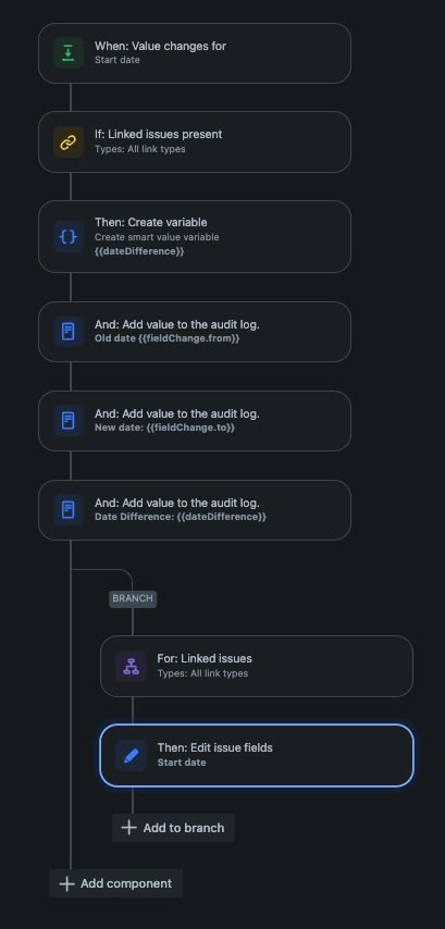

I'm trying to create, where if I change the start date of an issue for the issue linked, it should change the start date with the same number of days than the parent link.
I figured out a way to create a variable where it calculates the number of days that has change (minus or plus).
Everything is showing correctly in the audit log, if I change the start date for 3 days if show "3", I also have a "SUCCESS" showing, but the start date on the linked issues is being emptied ...
Here is the automation :
And here is the value inside my edit field start date (customfield_id = start date)
{{issue.customfield_10083.plusDays(dateDifference).jiraDate}}
I'm not sure where it blocks and why the field is being emptied ... If anyone has an idea on this !
Thank you !
Have a nice day !

Hi @Joseph HANI
First, I recommend reviewing this article from @Trudy P Claspill on this type of scenario:
https://community.atlassian.com/t5/Jira-articles/Updating-dependent-task-s-dates-when-predecessor-task-date/ba-p/2816977
For the rule you show, a Created Variable is passed as a parameter to the plusDays() function.  That parameter should be a number but variables are always text.  Please try adding asNumber to convert the value:
{{issue.customfield_10083.plusDays(dateDifference.asNumber).jiraDate}}

Joseph HANI
January 28, 2025
Hello @Bill Sheboy
Thank you very much for your answer ! You are always a great help ! So bad this articles does not come up in my google search (sob)
You were right !! Using the "as number" made it work like a charm !
