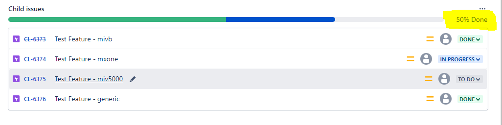

Second part to my problem is that I am unable figure out if there is a way to get the progress % over to Project A - Epic 1 from Project B

Next regarding the % progress...first how do you want to measure progress?  The image you show is of a parent and child issues.  That progress indicator is by the status category of issues.  There are other ways to measure progress, such as based on the aggregate of your estimation values.
Once you have selected your progress method, you could use the issues in the lookup issues and smart value list filtering (or separate lookup calls) to compute the result.

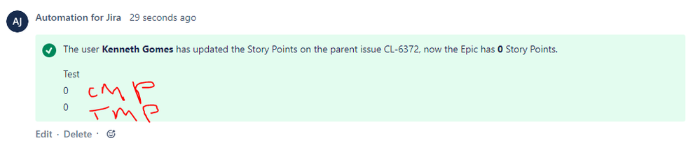

kenneth.gomes
October 26, 2022
Hi Bill,

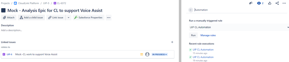

I got access to run the rule globally but for some reason the story points are not being summed up. I haven't used your formula yet but instead I tried to keep it simple by using {{lookupissues.Story Points.sum}} but the automation still wont sum up the story points.
Log

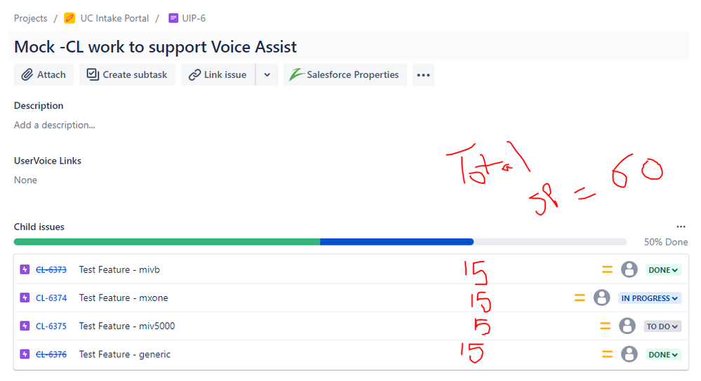

Based on the automation it is able to pick up the linked PE but it is unable to sum up the epics underneath it.
CL - 6372 is a Epic
UIP-6 is a Portfolio Epic
I am trying to sum up the child issues underneath them.

Bill Sheboy
October 26, 2022
I notice two things: there is an extra space before the smart value and the case is incorrect.  FYI that smart values are name, spacing, and case sensitive.
Please try this one if you are using a company-managed project (CMP):
{{lookupIssues.Story points.sum|0}}
If instead you are using a team-managed project (TMP), they use Story point estimate:
{{lookupIssues.Story point estimate.sum|0}}
I also added the default value of zero (0) so even if the fields are empty you will get a number.

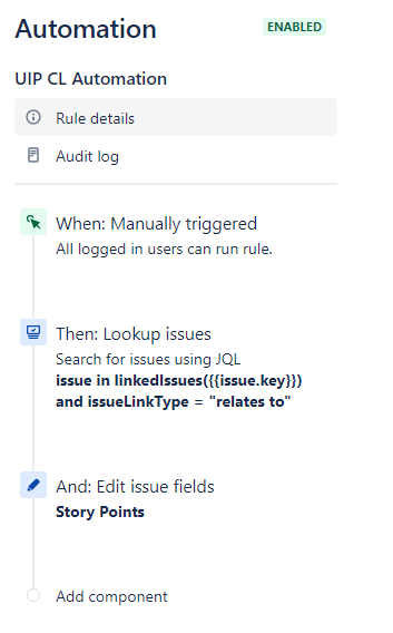

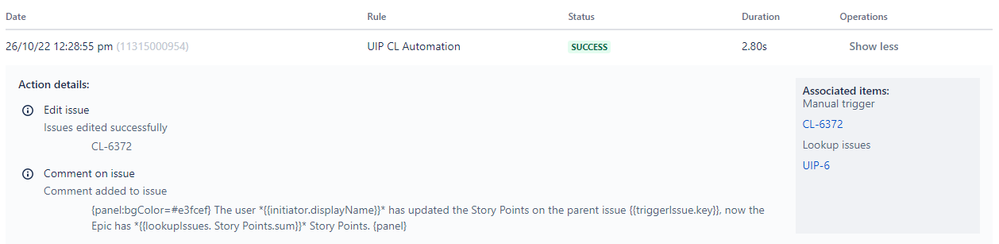

kenneth.gomes
October 26, 2022
Hi Bill,
Here is the complete rule;
I trigger it manually from this epic
The look up is able to look up the related to ticket i.e. UIP-6
But it is unable to lookup the children within UIP-6 and sum up the SP values.

Bill Sheboy
October 26, 2022
Did you see my note about using "Story point estimate" rather than "Story points"?  That should work for a team-managed project (formerly called NextGen).
Next, you appear to be trying to sum child issues of the epic, not the linked issues.
Please try changing the Lookup Issues JQL to  this:
parent = {{triggerIssue.key}}

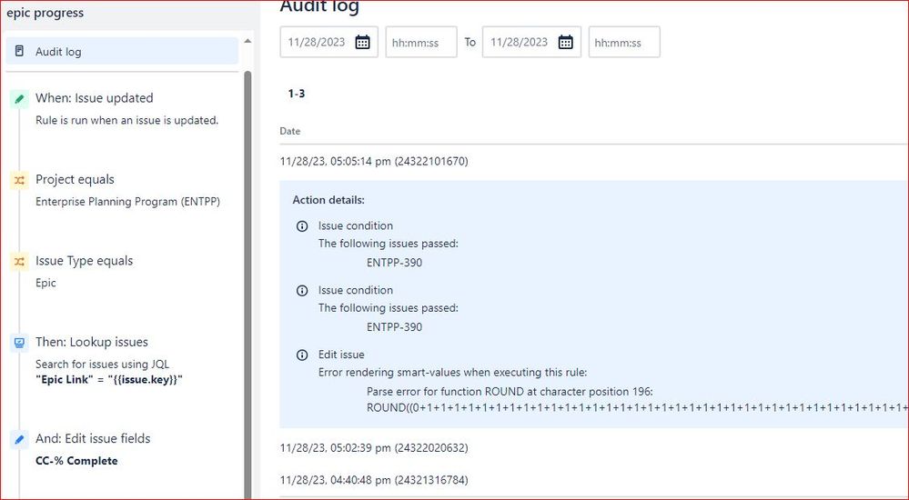

This is for company-managed projects.  I want to calculate % complete on Epics based on the number of children.  I have created an automation rule using your magic formula
{{#=}}ROUND((0+{{#lookupIssues}}{{#if(equals(status.statusCategory.name,"Done"))}}1+{{/}}{{/}}0)/{{lookupIssues.size|0}})*100,0){{/}}
but get this error
Your help would be greatly appreciated.
Bill Sheboy
November 28, 2023
Hi @Coco S ChaussĆ©e
Looking at your expression, there is a parenthesis in the wrong place.  It appears my original post had an error, and I have corrected that.  Tip: it helps to create expressions like this in a text editor which shows matched / mismatched parentheses and brackets.
Here is the corrected one:
{{#=}}ROUND((0+{{#lookupIssues}}{{#if(equals(status.statusCategory.name,"Done"))}}1+{{/}}{{/}}0)/{{lookupIssues.size|0}}*100,0){{/}}
It can also help to build expressions like this, piece by piece, and then combine them.  Here is an updated version of how I did that (except with the plus signs added at the front rather than behind the ones).
Completed issues count:
( 0{{#lookupIssues}}{{#if(equals(status.statusCategory.name,"Done"))}}+1{{/}}{{/}} )
Total issues count:
The percentage divides those two values:
{{#=}}( 0{{#lookupIssues}}{{#if(equals(status.statusCategory.name,"Done"))}}+1{{/}}{{/}} ) / {{lookupIssues.size|0}} * 100{{/}}
Finally, the percentage, rounded to a whole number would be:
{{#=}}ROUND( ( 0{{#lookupIssues}}{{#if(equals(status.statusCategory.name,"Done"))}}+1{{/}}{{/}} ) / {{lookupIssues.size|0}} * 100, 0){{/}}
