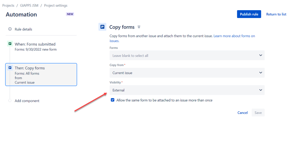

One possible thing you can do using automation with a rule configured triggered when a Form is attached event, and then copy the existing Form and change the visibility of the copied Form to External. I have not personally tried it yet, but you can give a try...

I have updated my original response to include a possible automation rule setup that you can give it a try.

Joseph,
Thank you for the suggestion. It does allow for a copy of the form to be immediately viewable by the submitter, but on the agent side there are two copies of the form. While less ideal, this can serve our needs as a temporary workaround until Atlassian can provide more in-depth automation options regarding Forms.
