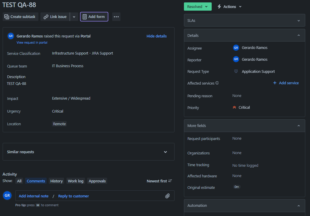

now @Joseph Chung Yin what is says Carlos is rigth those automations change the priority once the incident is created what I want is change the priority according to the Impact and the Urgency if it's possible before the incident is triggered as it work in another apps like Service Now, so let me show you what is happening
i'll share you 2 images and explain a little bit what i'm trying to do
I wanna set an on call schedule and some priority rules all this to allow users use JIRA Mobile
so what is happening here is that when you trigger and incident the priority Low is set as default then the automation that i have set run and according to the urgency and impact the priority will change.

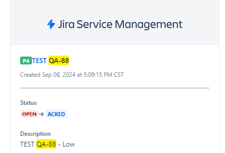

But this behaviour is not correct or it should not work on this way cuz inicially JIRA is creating the inciden as Low and on the way it changes its priority wich means that originally the incident is being triggered as Low and this is causing that JIRA mobile shows incident's priority as the default value and you can see it in the images
Incident was created as
Impact: Extensive / widespread
Urgency: Critical
which means Priority is Critical
but if you see the Email screen in description I tag the priority and it shows Low and in the name priority P4 aditionally the notification that i'm receiving en JIRA mobile is P4 and this is why the on call is no working a it should

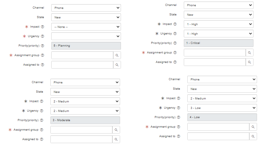

I share an image from SN to let you know how is it working and how is expect JIRA works too :)
i doesn't matter if it is a P1 or a P2 priority aplication and Email always is gonna take the default proprity as first configuration i'would eventually change but on its way
