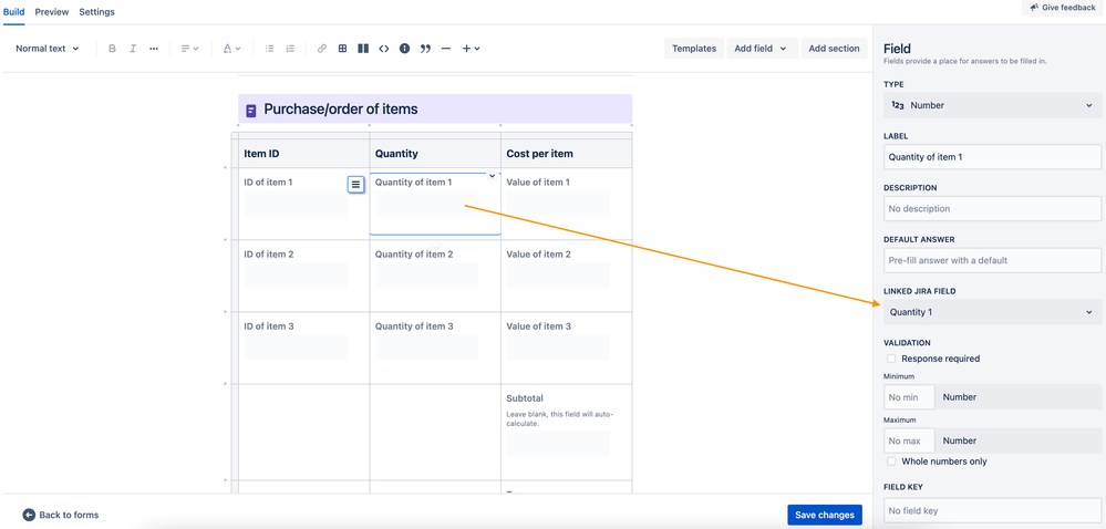

    • It will need to link all form fields to custom Jira fields (this is necessary for the A4J to be able to get the answers from the fields):Screen Shot 2022-12-23 at 11.18.43.png
       For more information, please refer to the documentation Link a form field to a Jira field.
    • For fields that will hold calculated values, you can use the description property to tell the user/customer that they do not fill out the field. (Jira Forms does not currently have read-only fields:  JSDCLOUD-10701 - Form Field: Read only fields)

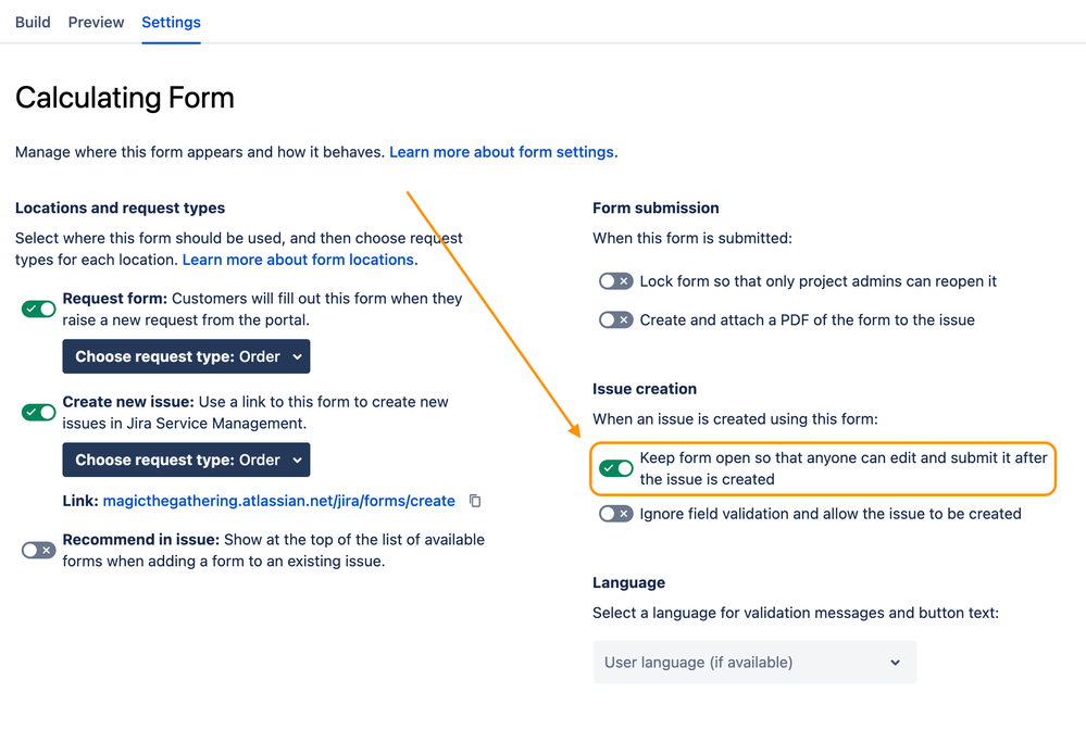

    • And it will be necessary to leave the form open on issue creation (this is necessary for having communication between Jira Forms and the A4J):Screen Shot 2022-12-23 at 11.25.28.png

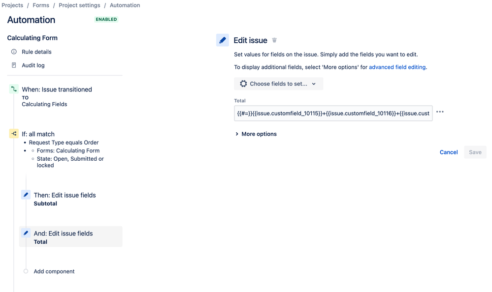

    • Use the Edit issue fields action to perform the calculation. You will need to reference the custom field ID in the rule, in this example I used the multiplication of the items and then their sum to calculate the subtotal:
      {{#=}}{{issue.customfield_10104}}*{{issue.customfield_10109}}+{{issue.customfield_10105}}*{{issue.customfield_10110}}+{{issue.customfield_10106}}*{{issue.customfield_10111}}{{/}}
    • So the icing on the cake for calculating the total is to put the Subtotal on the end of the smart value order (This is because there is a timing issue on the automation rule, as the Subtotal is still being calculated and does not have the value to be added in the Edit action of the Total):
      {{#=}}{{issue.customfield_10115}}+{{issue.customfield_10116}}+{{issue.customfield_10114}}{{/}}
       The customfield_10114 is the Subtotal field. To find the custom field ID please take a look at this documentation.
