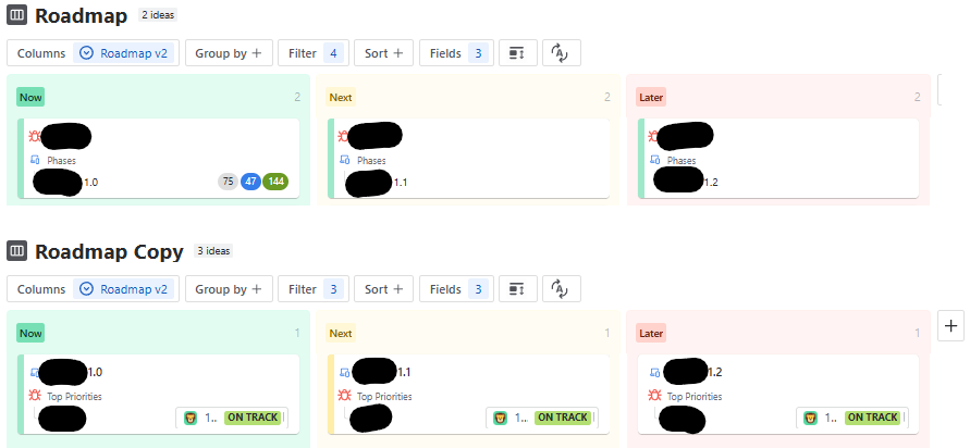

If I understood the connections concept I should be able to visualize the connections in any direction. There is no real parent or child relationship.
When I try this with a simple board view it does not seem to work:
  1. Types: Initiative, Phase
  2. Connection fields: Initiatives, Phases
  3. Created one initiative with 3 phases
  4. Roadmap board with Now Next Later.
  5. Initiative board: filter by type Initiative, filter by Phases "group by column" -> works
  6. Phase board: filter by type Phase, filter by Initiatives "group by column" -> doesn't work
In the Initiative board I see the Phases as sub items on the card. I would expect to see the same structure reversed in the Phase board. I've tried reducing the simplicity down to nearly zero, but can't make it work.
Is my assumption correct, this should work? Or did I misunderstand the feature.

For clarity, here's what I was trying to do:
Essentially just flip around the view. On the top I'm viewing the roadmap from a "Top Priorities" perspective, and on the bottom from a "Phases" perspective.
What I was missing was simply filtering for the right "connection" field. It was a really simple error to make on my part, but was surprisingly tricky to find. I hadn't yet internalized that in order for the connected item to be visible, it's the connection field that matters. It has to be marked as a visible field in the Fields area, it's not enough to add the type to the filter.
It was essentially a fix to my understanding of the way the connection feature is created.  Just wanted to share here in case others benefit :)
