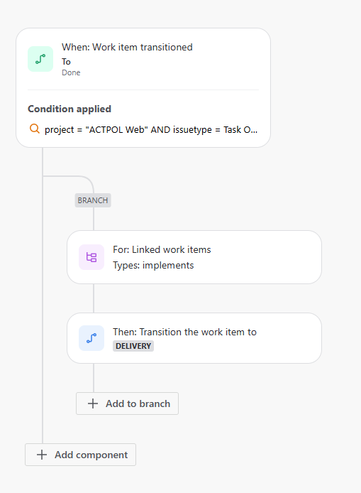

Hi all,
I'm trying to set up basic global automation rule, to adjust the JPD idea Status to "Done" when a linked Jira work ticket is transitioned to "Done" status there.
I've based the rule on the JPD demo vid HERE and have validated those steps in several other community posts. However, I just can't get this to work.image (3).png
Has anyone else managed this?
Thanks

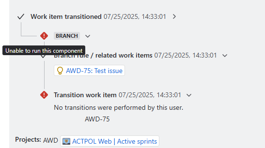

For a question like this, context of your specific rule is important for the community to help.  Please post the following:
  • an image of your complete automation rule in a single image for continuity
  • images of any relevant actions / conditions / branches
  • an image of the audit log details showing the rule execution
  • explain what is not working as expected and why you believe that to be the case

Sorry - I've now added the images.
What I expected having added this global rule: when the Jira work item status changes to Done, that this would trigger the linked Idea to status Done as well. (Please disregard the "Delivery" in the image - we were playing around to see if it would work with other statuses.)
Instead, Idea status remains same as prior to the automation running.

Who is the rule actor in the details at the top: the default of Automation for Jira or someone else?
I believe only users with JPD permissions to modify Ideas can perform the transition (e.g., a person with Creator role).  If it is the default user, please try changing it to someone with permissions to update Idea and re-test.

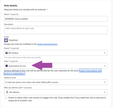

Bill Sheboy
July 26, 2025
I was asking about the automation rule actor.  Which user is used in the rule, as you see in this example below:

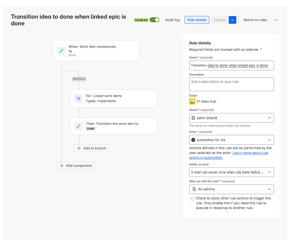

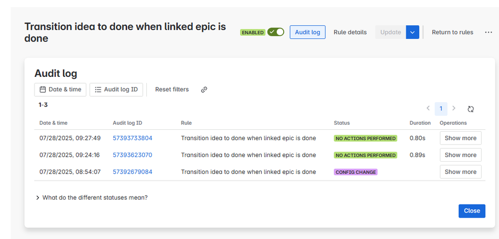

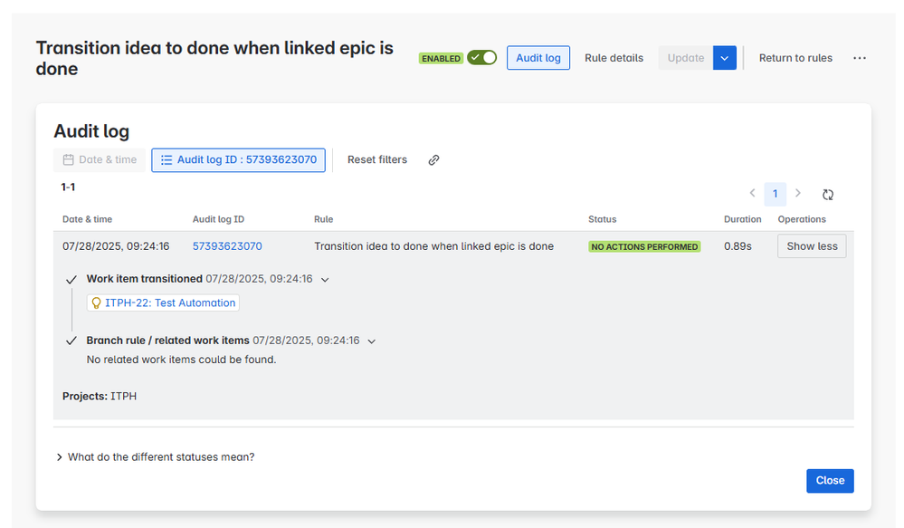

Hello @Boris Ahrendt hello @Bill Sheboy ,
actually I have the same problem.
I am attaching screenshots of my automation rule. My audit log shows messages indicating that the automation was executed, but no actions were performed. What I don't understand is that when I set the linked task to ā€œDone,ā€ nothing happens. However, when I set the idea to ā€˜Done’ instead (as a test), the entry appears in the audit log (and the task is not set to ā€œDoneā€). It seems as if the logic is somehow working backwards?
I think there sould also exist a template for exact this automation, see comment from @Hermance NDounga on this Loom video, and listing in this Intro article. This would probably be the easiest solution to make it work - but I just can't find it.. - can you see it?
Thank you all in advance!28-07-2025_09-34-10.PNG28-07-2025_09-33-30.PNG28-07-2025_09-33-51.PNG

Katrin Erhardt
July 28, 2025
Hello @Bill Sheboy I just changed the rule actor as you suggested. But the behaviour is the same as I described above: When I set the linked task to ā€œDone,ā€ nothing happens. But when I set the idea to ā€˜Done’ instead (as a test), the audit log shows the idea as "work item transitioned" with no related work items.. Is it a logical flaw?

Hi @Katrin Erhardt
The rule you showed in the image has a single-project scope.  That means the rule can create (or clone) work items into other projects but not access them in any other way.
Please change your rule scope to multiple-project, selecting the relevant ones, or global, adding any conditions on project needed to manage the behavior.
Your Jira Site Admin will need to help change the rule scope in the global settings because larger scope rules have a higher impact / risks for the site.
Thanks!
