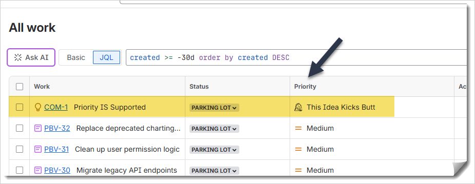

You can set the priority field on any issue (work item).  Its a core field that has been in place since the beginning.
The fact you can't display it on a screen is a shame
But I will bet you will prefer to have the priority set for your plugin or whatever other purpose spawned the original question.
See the screen shot below.  You can put a priority on your JPD issues one of 3 ways.
  1. On the issue navigator - line edit
  2. Using Bulk Edit if you need to do this frequently
  3. through auomation either by using logic to determine the core priority or by copyig the value from your JPD custom priority field it sounds like you may have chosen

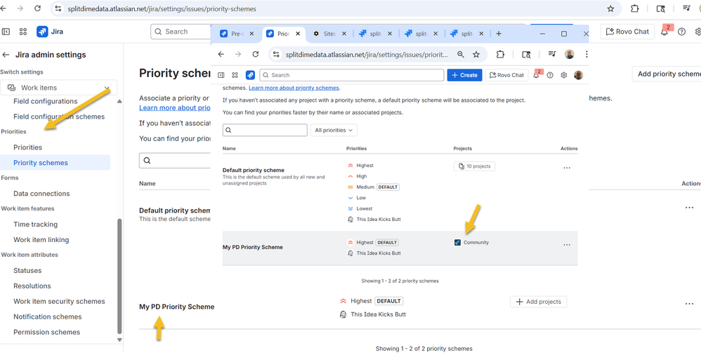

Step 1 – Create a Priority Scheme
  1. In Jira settings → Issues → Priorities, define the set of priorities your team will use.
    (Example: High, Medium, Low — or whatever matches your process.)
  2. Create a Priority Scheme that includes these values.
Step 2 – Associate the Scheme with Your JPD Project
  1. In Jira settings → Issues → Priority schemes, select your scheme.
  2. Associate the scheme with your Jira Product Discovery project.
This ensures the Priority field is available for all Idea issues in that project.

Lets see if this works....   I created a new Priority Scheme, a New Product Discovery Project, and a new Priority called "This Idea Kicks Butt".     I was able to add my new priority to my new priorty scheme and then assign the scheme to my Product Discovery Project.
Does this not result in an ability to manage priorities or JPD?
