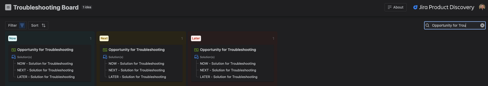

I've created a board view that uses the typical opportunity > solution hierarchy to show a product roadmap:
  • The board columns are the typical now/next/later roadmap.
  • The cards are opportunities.
  • Within the opportunity cards, I'm showing the connected solutions filtered by now/next/later
  • I've published the view to share it with a customer
Actual results
  • The published board doesn't filter correctly the solution within the next/later cards, both cards show the same solutions (see screenshot below)
  • The original board does filter correctly

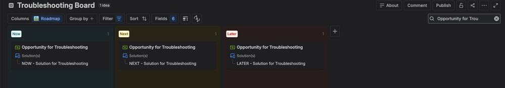

Expected
  • Both published and the original board have the same result wrt filtering (see screenshot of original board below)

Tanguy Crusson
November 4, 2025
Hi @Antoni Abella Vendrell , you're right, that's a bug! We're currently working on it, as we prepare to take hierarchies out of beta
October 21, 2025
Thanks for the reply @John Funk , I've added the screenshots in the main description above.
