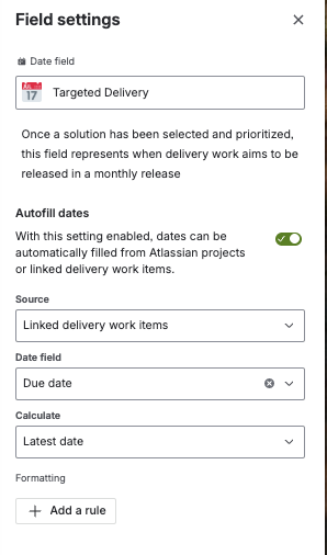

Great question @Bill Sheboy ! I'm using the 'built in' functionality of JPD at the field level. I don't have a unique automation rule to reference the Due Date.

Thanks for that information, @Lissa Radman as it explains the cause...
For JPD auto-filled and formula fields, the value is only shown in the UX and is not actually stored in the Idea.  Thus, JQL, automation rules, etc. cannot "see" the field value.
Worse still: if the field had a value before it was changed to auto-fill or formula, that old value will be used in things like automation rules!
I do not know know if the JPD team plans to change this behavior to actually store the calculated values.  Perhaps someone from that team will comment on any roadmap items to do so.
On to workarounds...
  • You could disable the auto-fill, and use a different automation rule to populate the "Targeted Delivery" date.  That will certainly require additional automation usage and a multiple project (or global) scope rule...which your Jira Product Admin will need to help with.
  • You could duplicate the logic of the auto-fill in your current rule.  To do that, your rule would use the Lookup Work Items action with JQL to gather the linked delivery work items, and then get the maximum due date with {{lookupIssues.duedate.max}}  Again, this will require a multiple-project (or global) scoped rule to access the issues in the lookup.  This approach also has the risk of the auto-fill configuration and rule getting out of synch, such as if you changed to use a different source than the Due Date.
