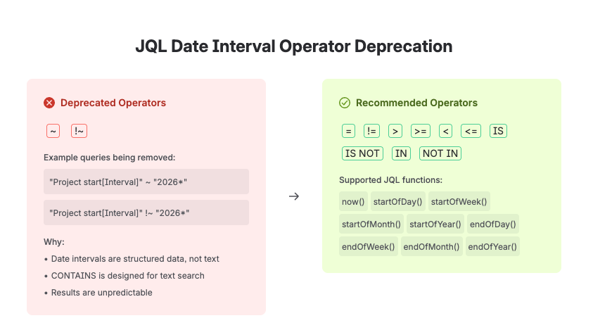

👉Do not use string manipulation 👈
If you're using string manipulation to work with date fields today we're going to announce a 3-month deprecation notice soo - this won't be supported anymore in a few months.
For example:
"Project start[Interval]" ~ "2026*"
Expect an announcement soon with more details.

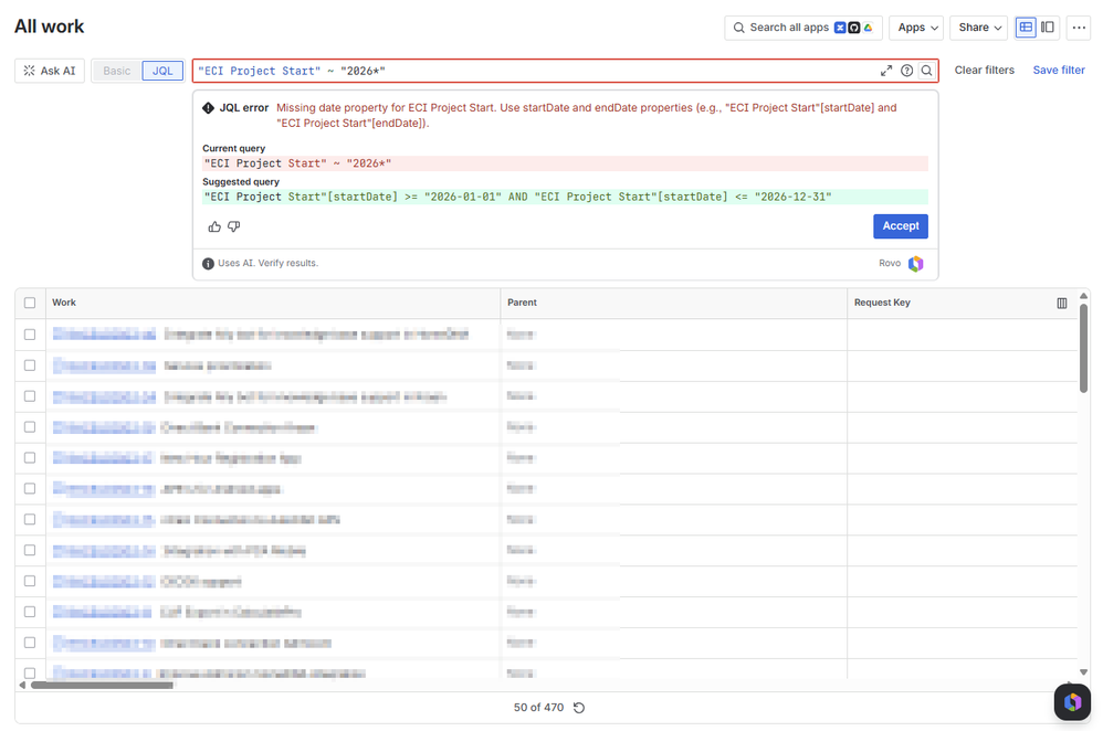

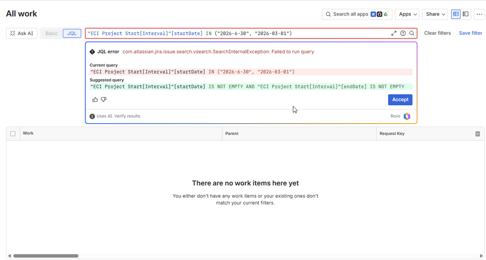

Dharmesh Sampat
July 21, 2026
Is this available? We are facing a lot of issues here.
I thought of testing this out, and this is what I see. Wondering what is going on. If @Tanguy Crusson can help, we will appreciate it.
If I use the old way of comparing dates as strings, I get results with an error.
