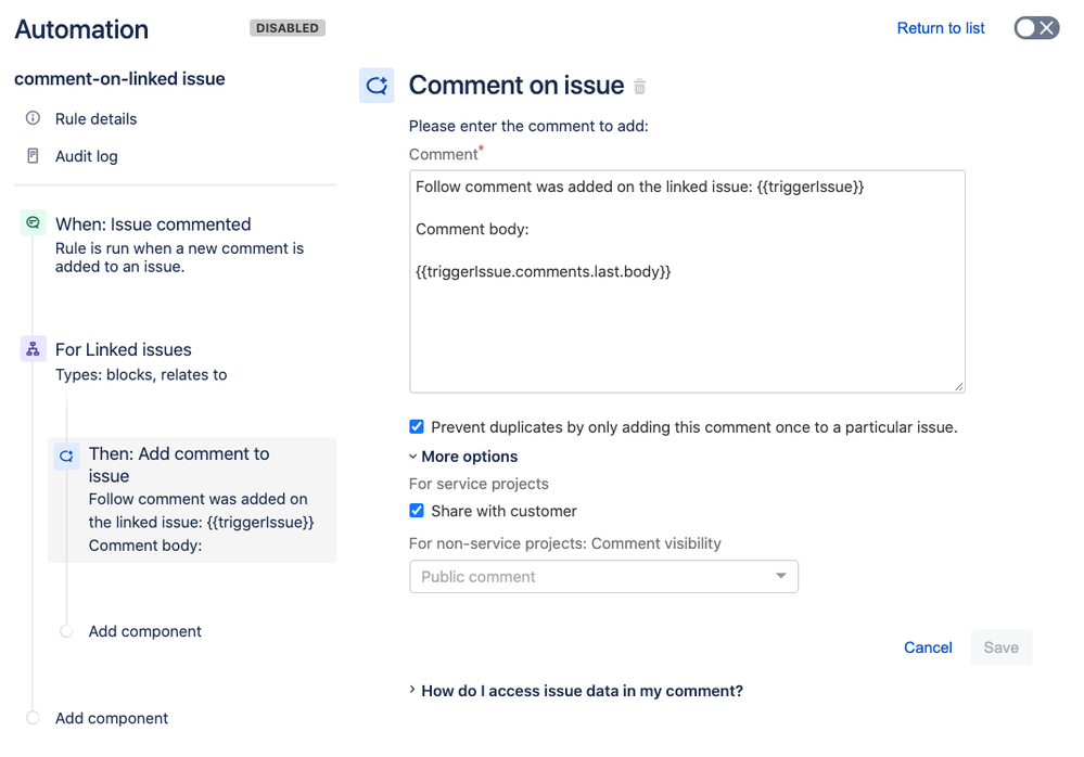

If the issues are linked to each other you can use automation rules to copy the comments by using smartvalues.
{{triggerIssue.comments.last.body}}
Check my rule here.
Not a sync but this is to copy from one issue to another. The idea is to update the original JSM ticket with all the updates happening internally. You also have the option to add/copy a public comment so customer can also be notified.
If made a detailed tutorial as well to explain how it works.
Ravi

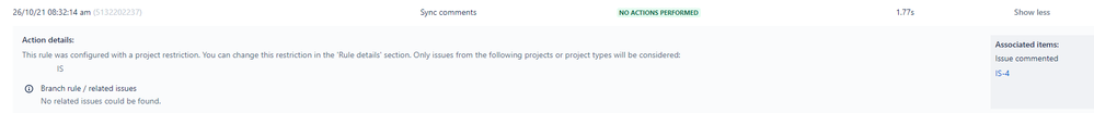

Did you get this to work? I am getting "No actions performed" in the audit log with the details:
"Branch rule / related issues
No related issues could be found."
Not sure if it has to do with permissions and if so how I would set that in my on prem installation of Jira (and/or JSM)

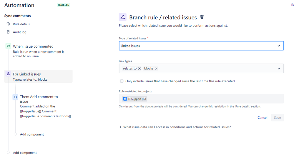

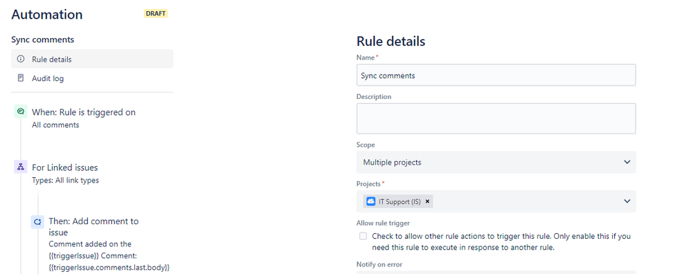

@Ola Carlander I see you only have one project on the screenshot, You need to go to global settings and change the scope to both projects

Thanks for the input! But the project on the other server is not visible to me from this page, I can only see projects on the same JSM site (not from my linked JS site).
This is what you refer to right?
Roshan Milinda
November 21, 2021
@Ola Carlander Sorry I was referring to Jira and JSM cloud instances. If you have admin access under the same login you should be able to see both.
Ola Carlander
November 22, 2021
I have admin access on both. but it is not under the same login as JSM and our on prem JS server does not have the same user database.
I do not think it is possible to have the same login accessing both?
Roshan Milinda
November 22, 2021
Yah. Probably best to talk to support team
