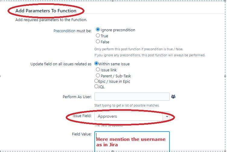

Andrey Delov
August 25, 2020
Hello,
Thanks for replying!
I do not see Issue Field: Approvers when I try to add Post Function to a transition. I can only see those:
  • Assignee
  • Description
  • Environment
  • Priority
  • Resolution
  • Summary
  • Original Estimate
  • Remaining Estimate
Do you know how can I add "Approvers" to this drop down menu?
Fahad Siddiqui
August 25, 2020
you need to select "Update Any Issue Field (JSU)"
