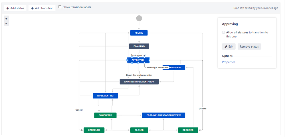

I am trying to set up a change management workflow and I'm following this document.
https://confluence.atlassian.com/servicemanagementserver/5-add-approvals-to-your-workflow-1082527843.html
On step 4 of the above, I'm not seeing the "Add Approval Configure" section on my workflow.  Here is what I see on my workflow below.  Am I missing a step somewhere?

Hi Bill - Welcome to the Atlassian Community!
The approver configuration is only available for Workflows connected to Jira Service Management projects. Also, the Workflow must be active (connected to a project) to be able to configure the approval.

I believe this is connected to my project as I go to my Project Settings>Workflows and see the "Change Management Workflow for Jir Service Management" there.  That is what I am clicking and trying to edit.

Are you sure this is a JSM project?
Bill Davis October 14, 2021
Ahh, I see now. It says "Software" under Project Type.  I don't see an option for Basic Service Desk or JSM.  So I must have missed something while installing the JSM components.

When you click on Create Project, you should be able to see Jira Service Management as an option if it is installed. But bottom line is the workflow needs to be on a JSM project to have the approval show up.  :-)
