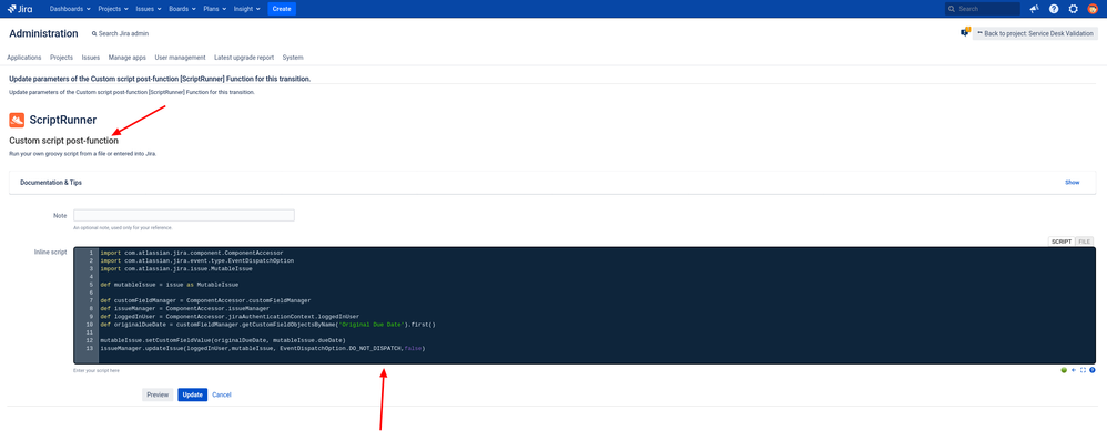

The Post-Function can be used to pass the value from the Due Date field to the custom field. However, the Post-Function is unable to set a field to Read-Only. To do this, you will need to use Behaviour.
Below is a sample working code for the Post-Function:-
import com.atlassian.jira.component.ComponentAccessor
import com.atlassian.jira.event.type.EventDispatchOption
import com.atlassian.jira.issue.MutableIssue
def mutableIssue = issue as MutableIssue
def customFieldManager = ComponentAccessor.customFieldManager
def issueManager = ComponentAccessor.issueManager
def loggedInUser = ComponentAccessor.jiraAuthenticationContext.loggedInUser
def originalDueDate = customFieldManager.getCustomFieldObjectsByName('Original Due Date').first()
mutableIssue.setCustomFieldValue(originalDueDate, issue.dueDate)
issueManager.updateIssue(loggedInUser, mutableIssue, EventDispatchOption.DO_NOT_DISPATCH, false)
Please note, this sample code is not 100% exact to your environment. Hence, you will need to modify it accordingly.
You will need to use the Custom Script Post-Function.
Below is a print screen of the Post-Screen configuration:-

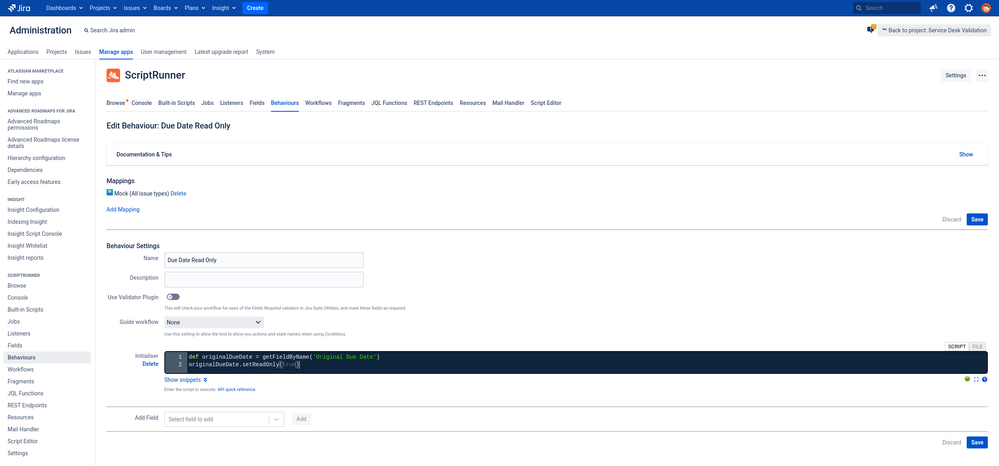

Next, you will need to setup a Behaviour Initialiser configuration for the custom field, which contains a copy of the original date.
Below is the sample code that is used in the Behaviour:-
def originalDueDate = getFieldByName('Original Due Date')
originalDueDate.setReadOnly(true)
This ensures that if any modification is attempted to the custom field, the Edit dialog will be displayed, and the custom field will be in Read-Only mode.
Below is a print screen of the Behaviour configuration:-
