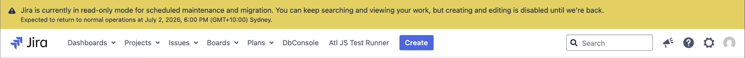

The global read-only mode banner as it appears to users The system-wide banner that tells everyone the instance is temporarily locked.

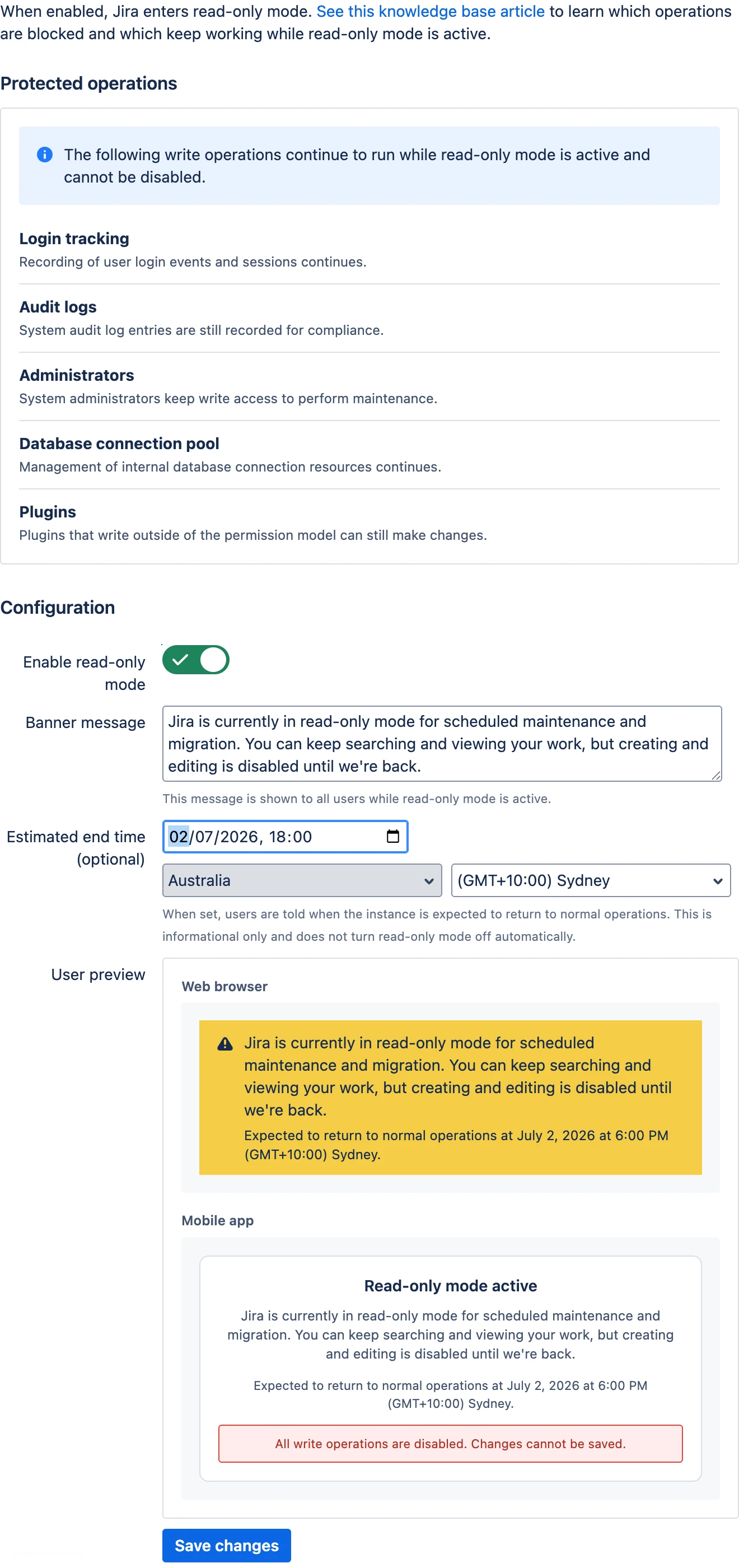

  1. Turn on the Enable read-only mode toggle.
  2. (Optional) Edit the Banner message users will see. The default is "Jira is currently in read-only mode for maintenance."
  3. (Optional) Set an Estimated end time and time zone. Users see this as "Expected to return to normal operations at …". It's informational only — it does not turn read-only mode off automatically.
  4. Save. Read-only mode takes effect immediately across the cluster.
The Read-only Mode configuration screen with the enable toggle, banner message, and estimated end time The configuration screen: enable toggle, custom banner message, and an optional estimated end time.

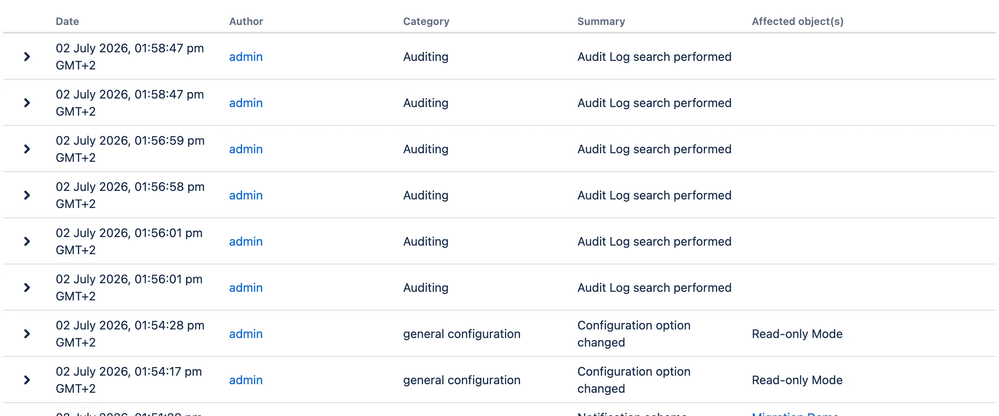

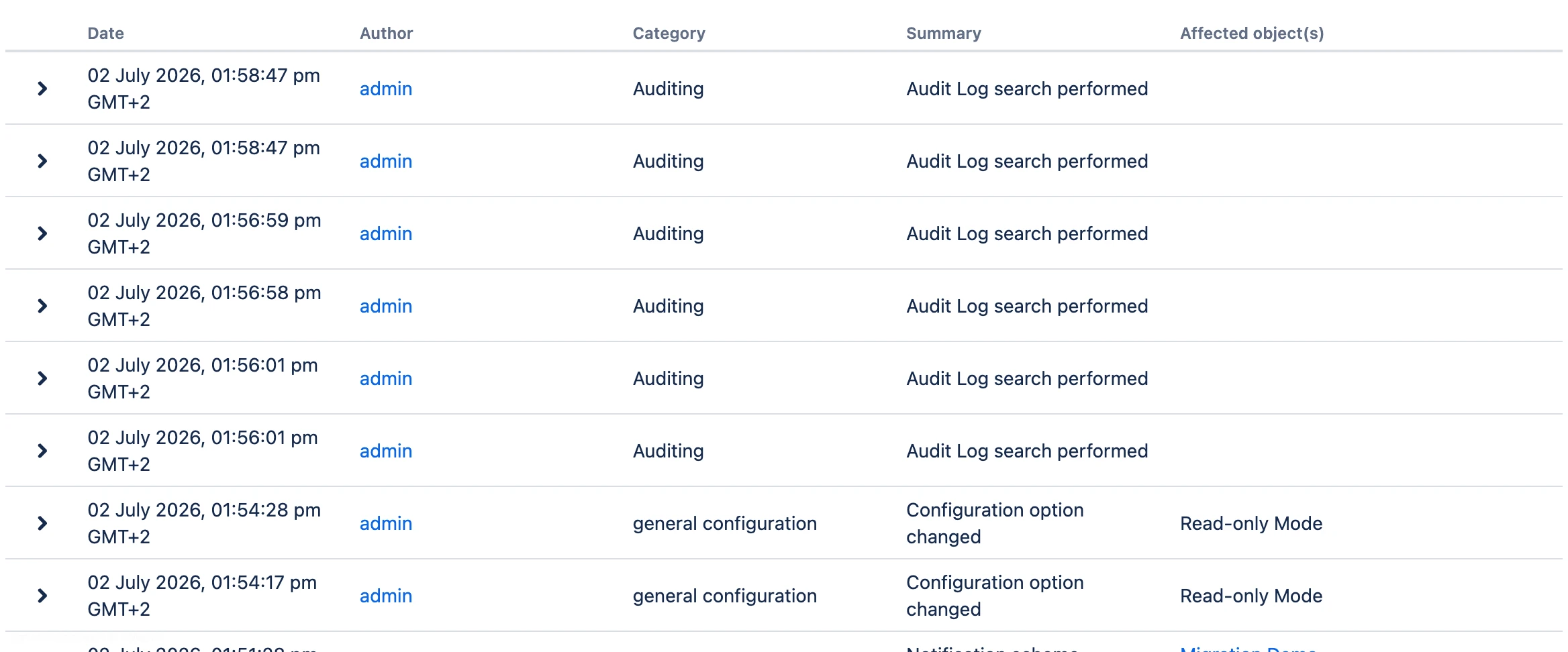

  • Who turned it on/off, and when? Every toggle is recorded in the Jira audit log — the same place other admin configuration changes land. Audit logging is a protected operation, so entries keep being written even while read-only mode is active. That gives you an accountable, retained record for reconstructing a maintenance timeline.
Audit log entry recording a read-only mode change The audit log captures who toggled read-only mode and when.
