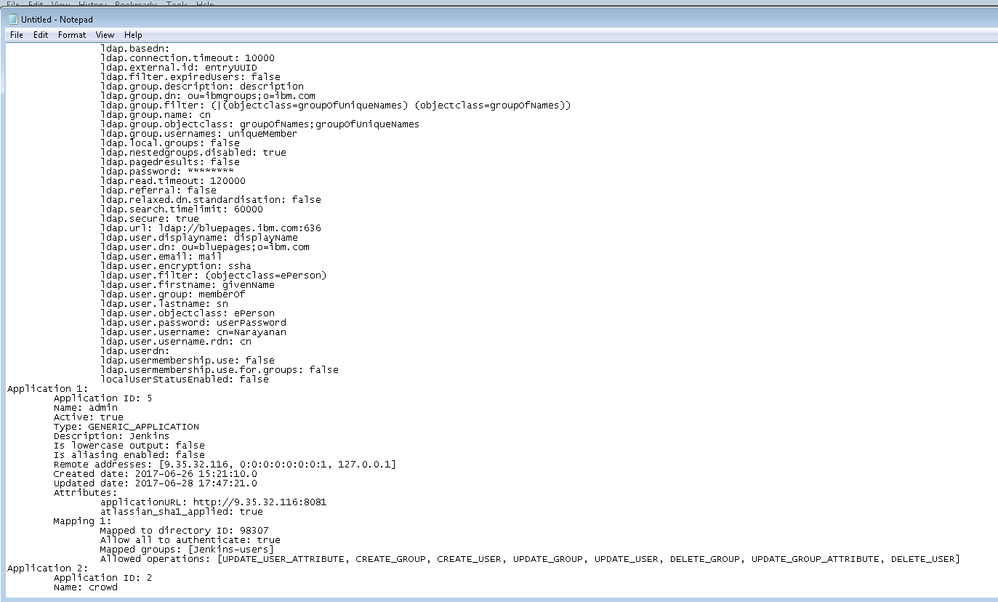

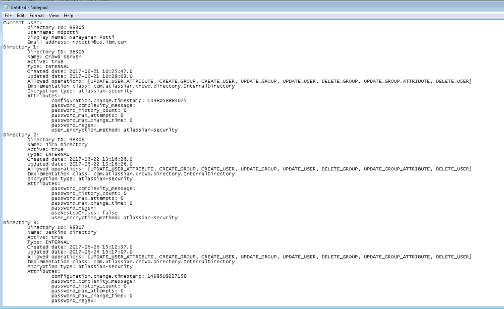

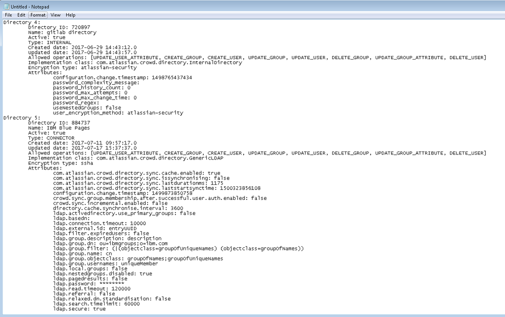

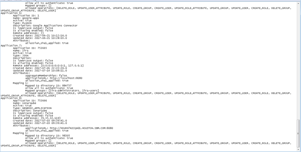

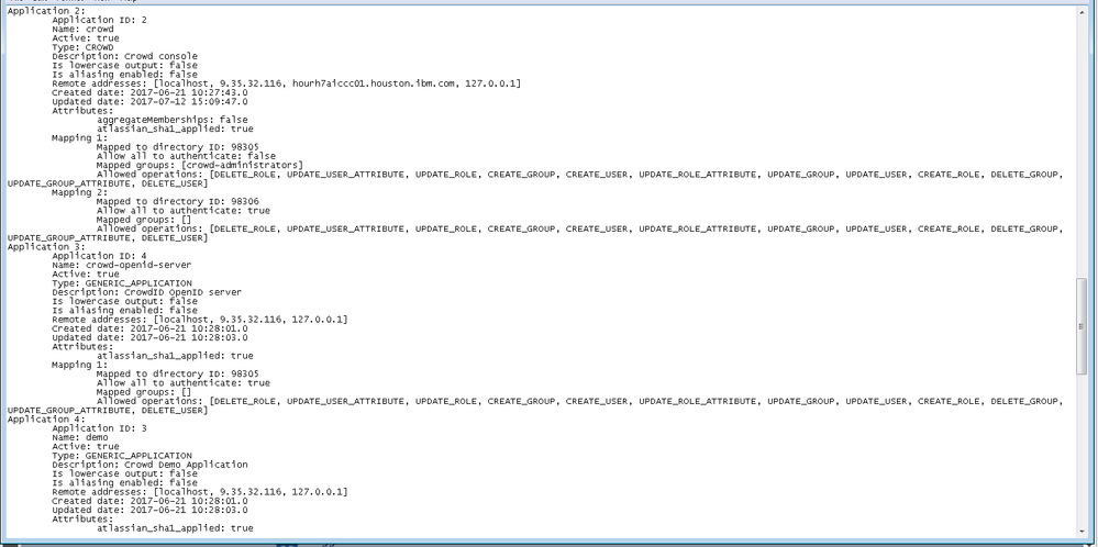

Uploaded Crowd system information. Please let me know if Crowd configuration can be changed to fix the issue with user not being to login to Jira.

On the Directory Configuration Summary I cannot find where the JIRA Directory was mapped to an Application.
Was this step completed?
1.2 Define the JIRA Application in Crowd
The application has to be defined in Crowd, and the JIRA directory defined in Crowd has to be "mapped" to that application. There are blow by blow instructions in the docs I linked.
pottind
July 17, 2017
Jira application is mapped to Blue Pages directory as below. Screen shot is attached. Crowd-directory-config-summary7.png
Application 7:
Application ID: 753665
Active: true
Type: JIRA
Description:
Is lowercase output: false
Is aliasing enabled: false
Remote addresses: [0:0:0:0:0:0:0:1, 127.0.0.1]
Created date: 2017-07-01 22:22:20.0
Updated date: 2017-07-14 10:08:11.0
Attributes:
aggregateMemberships: false
applicationURL: http://localhost:8080
atlassian_sha1_applied: true
Mapping 1:
Mapped to directory ID: 884737
Allow all to authenticate: true
Mapped groups: [jira-administrators, jira-users]
Allowed operations: [DELETE_ROLE, UPDATE_USER_ATTRIBUTE, UPDATE_ROLE, CREATE_GROUP, CREATE_USER, UPDATE_ROLE_ATTRIBUTE, UPDATE_GROUP, UPDATE_USER, CREATE_ROLE, DELETE_GROUP, UPDATE_GROUP_ATTRIBUTE, DELETE_USER]
