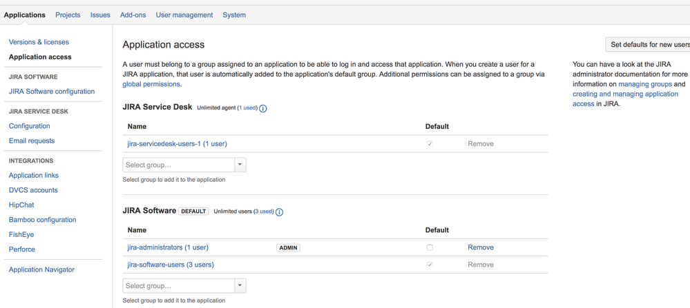

In JIRA go to Applications and then application Access. To log in, the user must belong to a group on that page: <Base_URL/secure/admin/ApplicationAccess.jspa. You can add your custom group at the bottom of the page:

Ann, Please ignore my question in the previous comment.  I think I resolved the issue I had.  I also had to assign Application Access to the Custom Directory groups in JIRA.  For instance, right now, I did the following in JIRA.
Cog Wheel -> System -> Applications -> Application Access.  And here I added the custom directory groups to the application access.  And now the Custom directory users from the added groups are able to login to JIRA without having to add them to JIRA administrators.

Sorry, I posted my comment before reading your reply.  Thanks!  This Application Access page resolved my issue.
