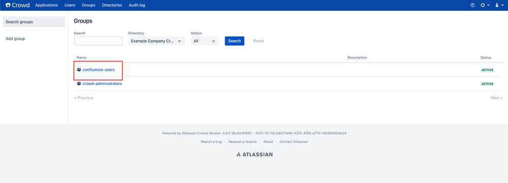

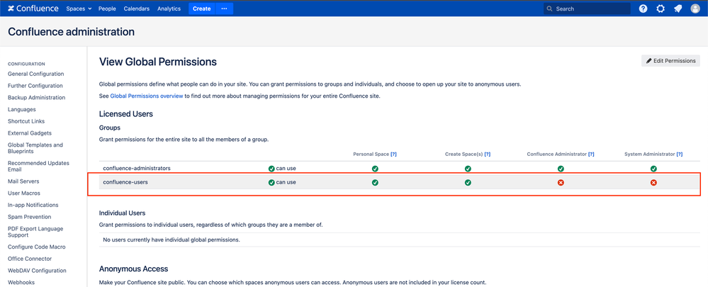

1) Make sure your users from directory are members of group, that exists in application and have all permission to authenticate

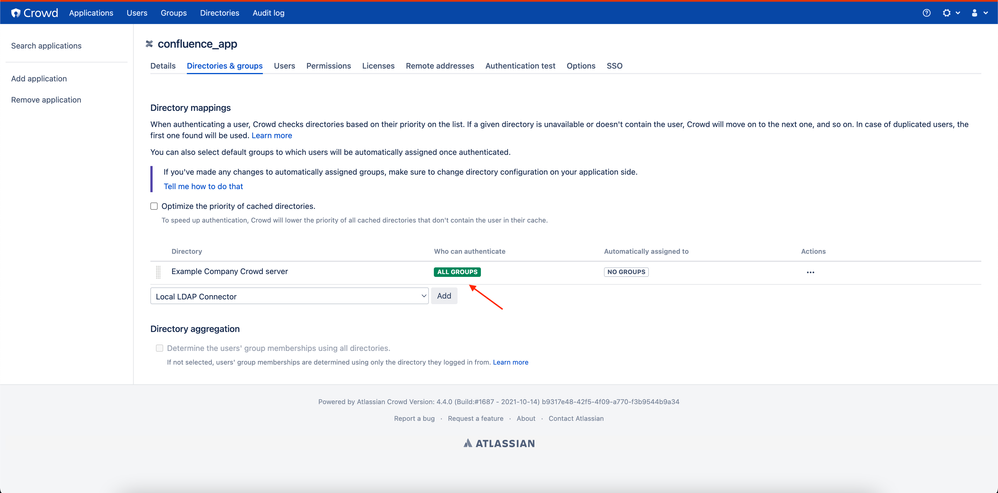

2) Check that in crowd in application settings you assigned the right groups that can authenticate, or to try to enable authentication to all groups from directory (just to make sure that it works)

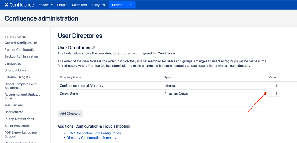

3) In your application in User Directories page, make sure, that Atlassian Crowd is enabled and it have the right directory order
To read more about directory order, I can give you few useful links: https://confluence.atlassian.com/conf716/configuring-user-directories-1108682916.htmlhttps://confluence.atlassian.com/conf716/managing-multiple-directories-1108682926.html
