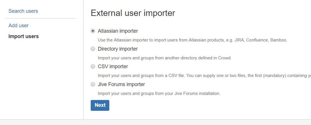

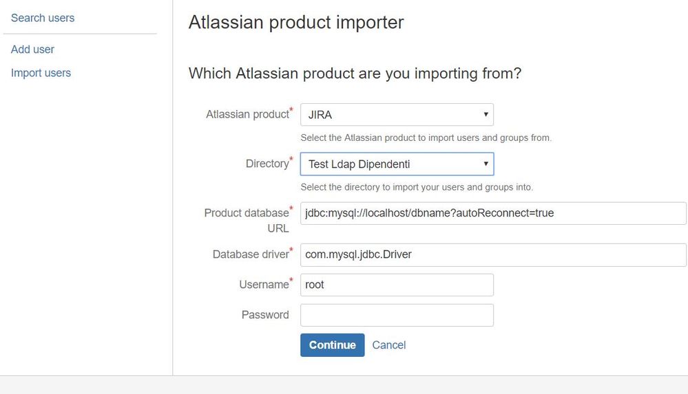

To import ,i select import Users in crowd and passes are shown on picturesCattura.JPGCattura1.JPG

The thing we want is having all groups with users like defined on Jira in our crowd .So we configure LDAP and internal directory for crowd and try to import from Jira. Users and groups are imported but some groups are empty because having users from LDAP.

The importer that you've used should have imported users along with their groups and memberships, could you check that by selecting a user from this imported directory in Crowd and checking they groups.
