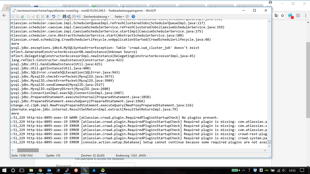

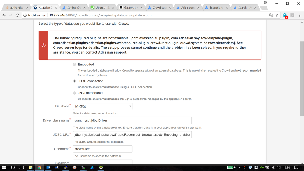

Hi there,
would be happy if anyone can give me a hint here: Gettiung error message that crowd install failed during startup.
Marcin Kempa
October 2, 2017
Hi @H-H
Looks like Crowd had some problems with creating 'cwd_cluster_job'. Are you using supported database?
If you could post all the logs it would be easier for us to diagnose the underlying problem.

found the problem. The collation within the database (
character set utf8 collate utf8_bin;
) was wrong. Now I was able to install. No problems.
