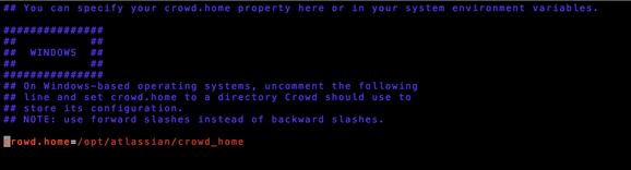

I am installing Crowd.
I refer to 'https://confluence.atlassian.com/crowd/installing-crowd-and-crowdid-191862.html'.
It looks like you installed it properly, but 'Start_crowd.bat' does not run.
Did you incorrectly modify the crowd-init.properties file?(see beloww)

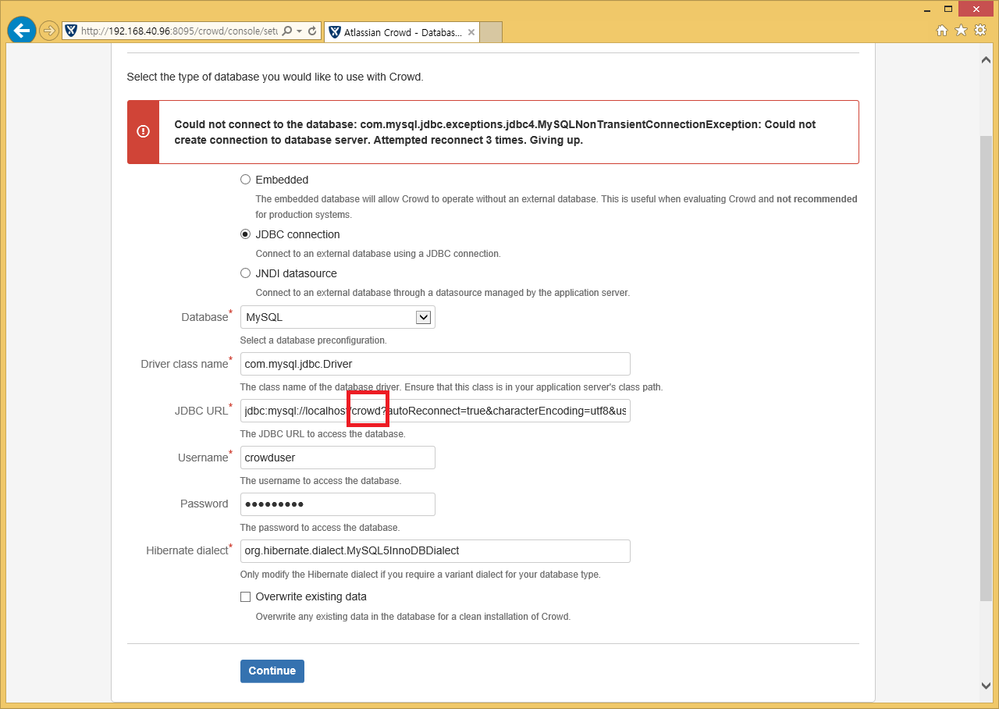

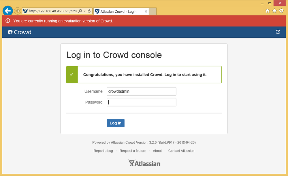

Oh, it is my mistake.  I knew the cause.
The crowd database instance name recorded in 'JDBC URL:' is incorrect.(crowd --> crowddb)
Thank you very much.

You must to create a directory at same structure at your installation of Crow, for example:
After that, you need to change de path at "crowd-init.properties"
<your home diretory>/crowd/crowd-webapp/WEB-INF/classes

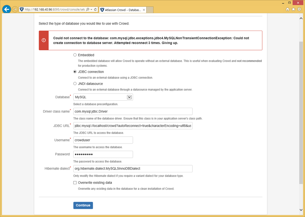

I do not know why, but when I re-work today, start_crowd.bat will run.  However, the following error occurs during the installation wizard.

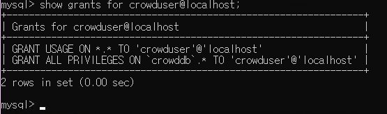

The permissions of the 'crowduser' account are fine.(See below)
The permissions of the crowduser account are fine.(See below)
Note that the mysql database name for 'Crowd' is crowddb.
