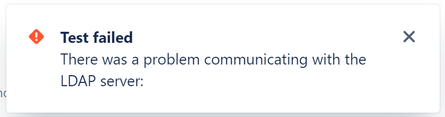

We are using Crowd 3.7.0 (Build:#1270 - 2019-10-03.
We configured the Connector
Url: ldap://mydomain.ldap.okta.com
SSL: LDAPS
When we Test the connection, we receive an incomplete error message:
There is no entry in the Log for this error, the Directory Sync works fine.
The implicit REST Call
https://crowd.autsrv.com/crowd/rest/directorymanagement/1/directory/testldap/01234567
doesnt return any response and no retrun code.
Any idea what is going on here ?
So far we didnt use a certificate when selecting "LDAPS".
Can this be the reason ? Do we have to use one or is selecting "LDAPS" sufficient ?

Hi @Hans Pesata
It works on my dev tenant.
I chose the 'Generic Directory Server' connector and 'LDAPS' as the security protocol.
The URL should be 'ldaps://yourdomain.ldap.okta.com:636'

HI @Bruno Vincent
Thanx for Your reply!
Interestingly, after rebooting our Server, the Test worked fine.
It is something that we have to keep in mind ...
