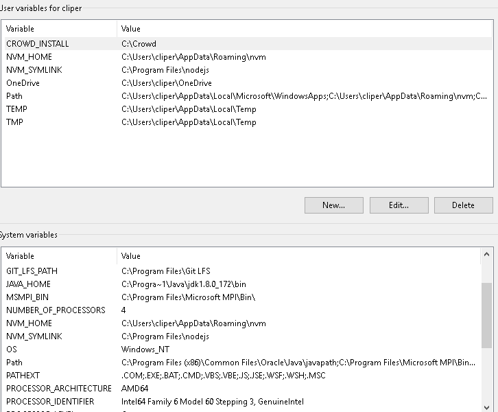

Here's my Environment variables looks like:
I tried everything from here, adding JRE_HOME, in Path variable that are suggested in the community forum and all still no luck.

cliper
June 29, 2018
Hi @AhmadDanial, thank you. I've fixed the issue already by removing the /bin in the path.
