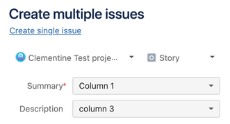

After you have selected the option to create multiple issues, you should be offered the option to specify which column is your summary and which one is  your description. After doing that, data should end up in the correct fields in your Jira issues:
Hope this helps!
