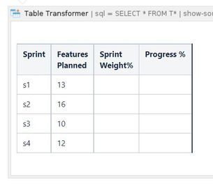

I'm trying to do a very basic calculation to find my sprint weight% and Progress% based on my sprint plan.
Below is my table. Now, how do i calculate the data here?
Sprint Weight %= (Features Planned in the specific sprint / total features in all sprints)*100
Progress% = Current Sprint weight + Previous progress %

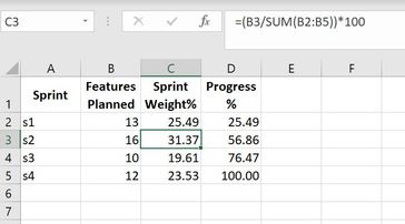

From a simple xls file, i can get my values as below. I have no clue how to achieve it in confluence.

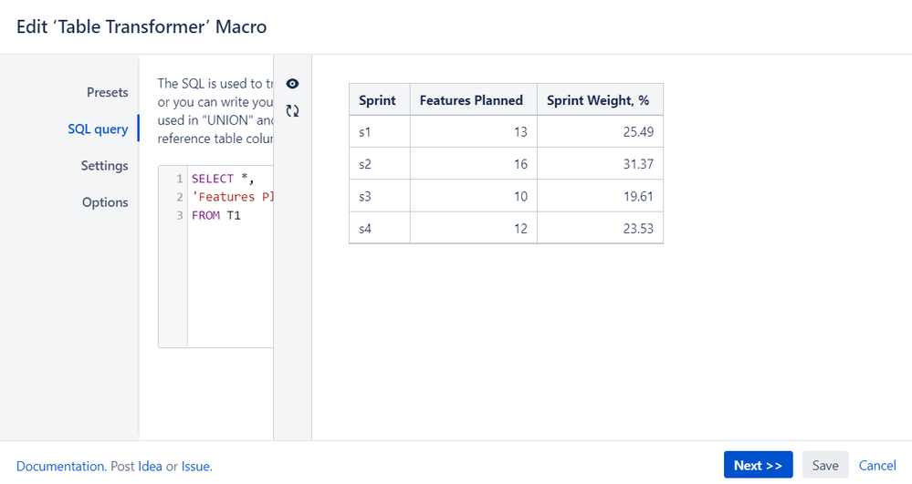

I've consulted with our developers, and they provided me with a better solution for your case based on the two Table Transformer macros:
Here is the SQL query for the first Table Transformer macro that is inside:
SELECT *,
'Features Planned' / (SELECT SUM(T1.'Features Planned') FROM T1) * 100 AS 'Sprint Weight, %'
FROM T1

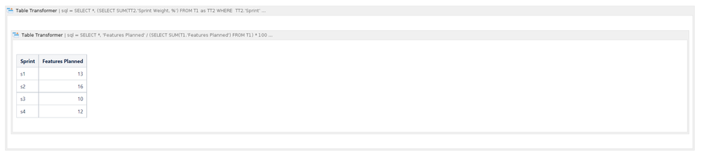

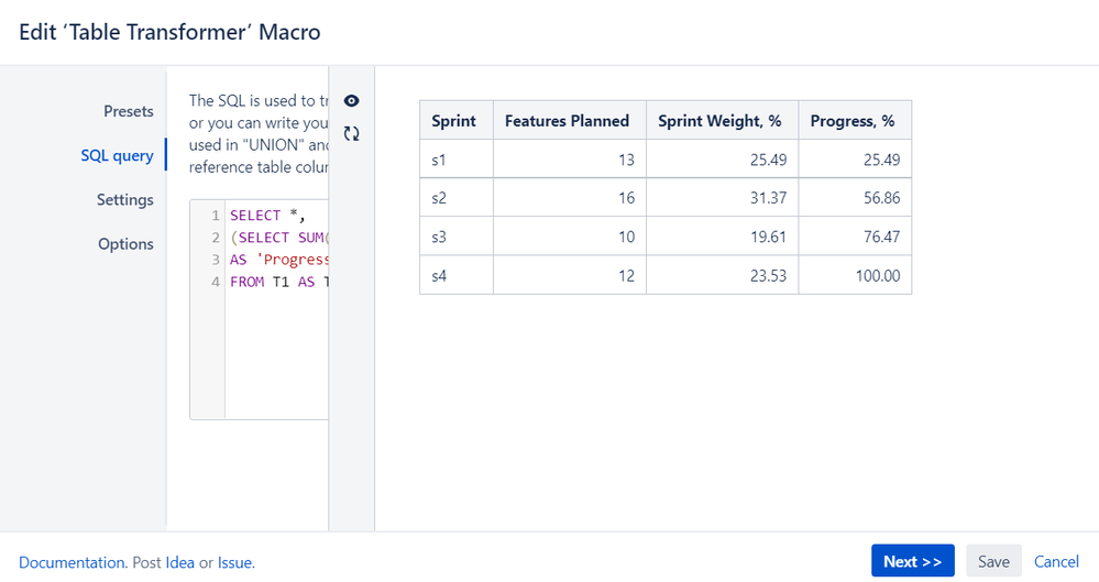

And here is the SQL query for the second Table Transformer macro:
SELECT *,
(SELECT SUM(TT2.'Sprint Weight, %') FROM T1 as TT2 WHERE TT2.'Sprint' <= TT1.'Sprint')
AS 'Progress, %'
FROM T1 AS TT1
Everything seems to work as it's shown on your screenshots.
