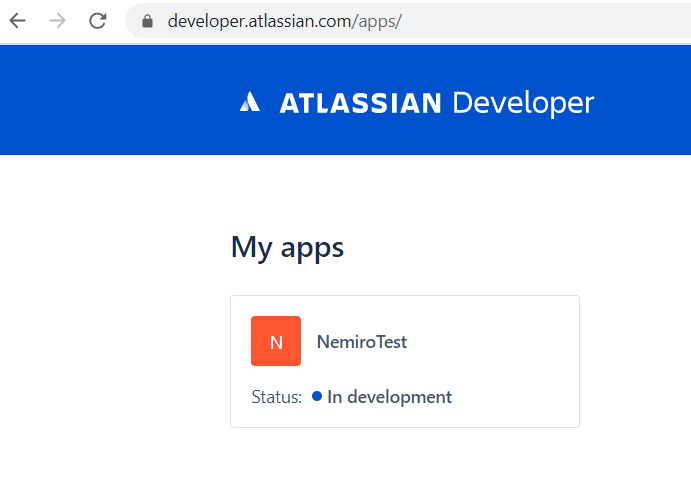

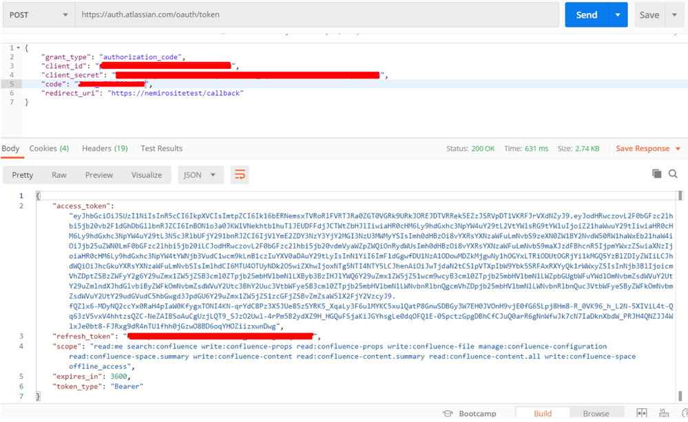

  3. Then got the access_token used the POST request:s3.png

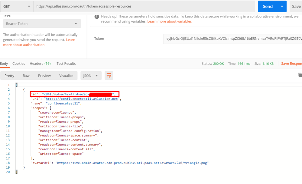

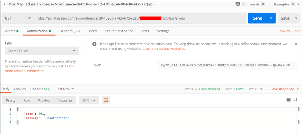

  5. Then i tried to execute the https://developer.atlassian.com/cloud/confluence/rest/#api-api-group-get

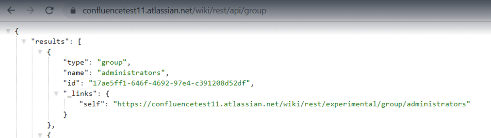

1. The request (https://developer.atlassian.com/cloud/confluence/rest/#api-api-group-get) works fine if i use the basic authentication.

Hello @nemiro_viktor ,
Welcome to the Atlassian Community.
As you can see, no OAUTH Scope is documented for the group endpoint. This actually means that the endpoint does not support Oauth 2 (3LO) yet.
I have just spoken to DEV and I have been told that they are already working to re-write the group endpoints to add the possibility to:
  • Create/Delete/Update Group
  • Added/Remove members to/From a Group
  • Use 3LO auth
You can vote and set yourself as a watcher to below Feature Request so that you will be notified in case of any progress:
I hope this clarifies.
