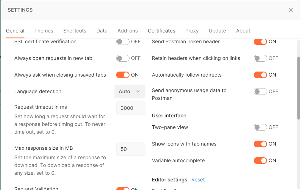

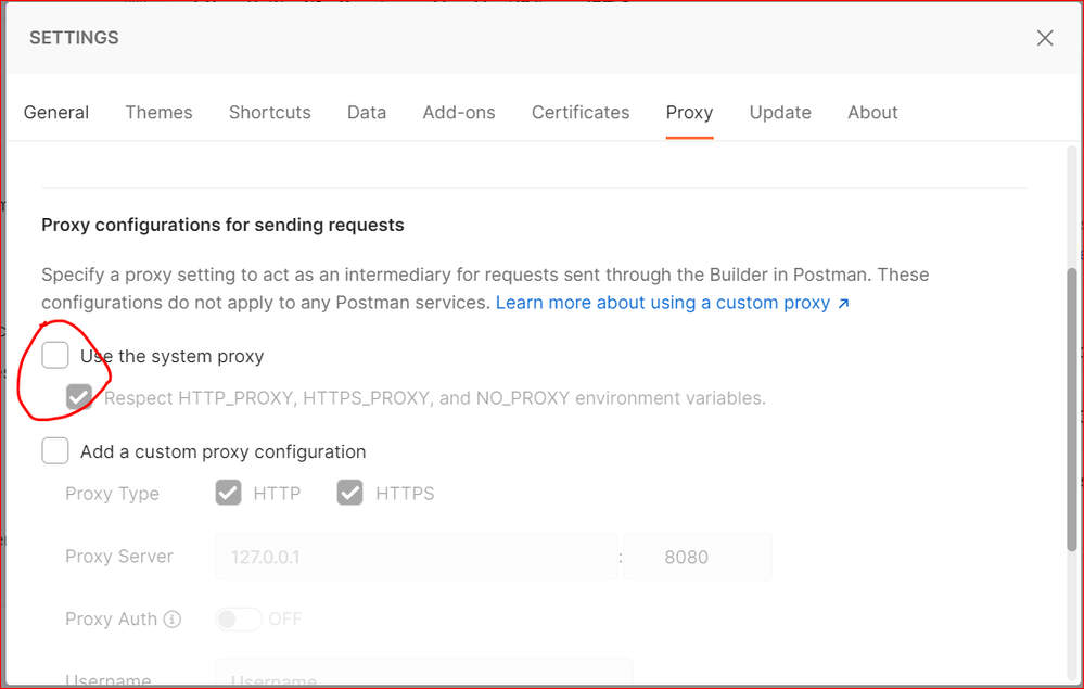

Srikanth Ganipisetty
November 29, 2023
Got it, thanks @Dario B  Please suggest if you want me to start a new thread instead. I thought the above relates to my issue and take your expertise to run the 1st call on our Jira Cloud POC app.
1. I have turned off the proxy as per the Stack Overflow suggestions and then the time-out is occurring. Do you know any way that I can trouble-shoot myself before I reach to the IT Team since it's related to Time -out now.
2. When I ran the script in Script runner to do in the other way for the same rest call (creating a user), It is asking me to authenticate first on JIRA Cloud, where as it didn't asked me to authenticate for creating a Story in a project using the same POST Method. and as you see it failed for GET call too in the 1st comment
Thanks,

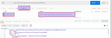

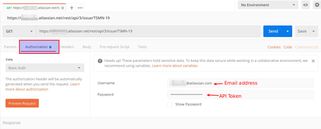

Also, it would be a good idea to double check you are using the right credentials by authenticating the same REST API call in e.g. POSTMAN and compare the authorization header in there:
1) Enter the credentials and the url in postman:
2) Execute the request (click on "Send").
3) Once getting the response switch to the "Headers" Section and compare the authentication header generated by Postman with the one you use in your code:

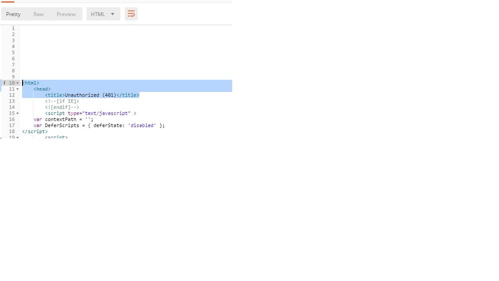

Omantha Prasad
June 25, 2019
I am still getting same error message when I tried through Postman as well.
Error message: <html>
<head>
<title>Unauthorized (401)</title>
a
Dario B
June 25, 2019
@Omantha Prasad
Then it can either be that you are using the  wrong credentials (you can try to generate a new API Token for the Atlassian Account you are using to authenticate the requests) or, as written at the bottom of the Basic auth for REST APIs documentation page:
