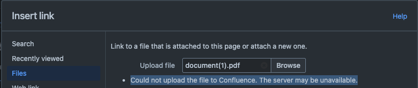

Hi everyone,
I recently upgraded my Confluence DataCentre instance from 9.2.x to 10.2.0. Everything is working fine post-upgrade, except the link file.
When editing a page and using Insert Link → Files → Browse to attach a new file, the dialogue displays:
Could not upload the file to Confluence. The server may be unavailable.
However, the file does get uploaded. If I close the dialogue and reopen Insert Link → Files, the file is in the attachment list. It may be a timeout error rather than an actual upload failure.
Checked the Base configured URL and it matches exactly with the URL that I am using.

I have raised the support request to the confluence and they have confirmed that its a known bug in 10.2.0 version of DataCenter.
Its related to this CONFSERVER-101052
