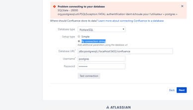

I installed confluence and postgres , when i try to connect my database to postgres , for the simple way , when i hit test connection : it looks succeded as picture describe below :
But when i hit next to finish the configuration , it takes a while and i get this error :
psql: FATAL: authentification Ident échouée pour l'utilisateur « postgres »
By connection string , the test failed :
I see that i have to change the pg_hba.conf and i did it : Here i my file :

But after the test succes it's charge and return this error always :
Note : i cleaned the cache but always same problems.

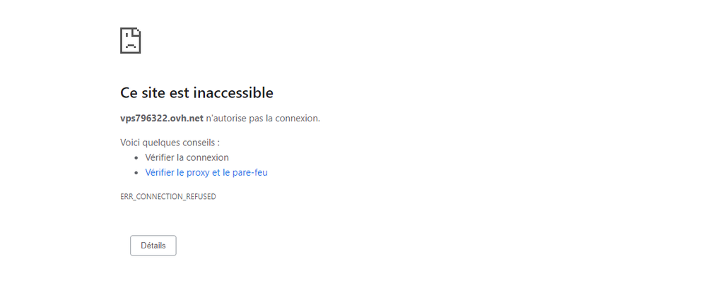

right now the problem with the user is solved , but when the test succed in two ways , it take a while and tell me
vps796322.ovh.net n'autorise pas la connexion.
Voici quelques conseils :
ERR_CONNECTION_REFUSED
