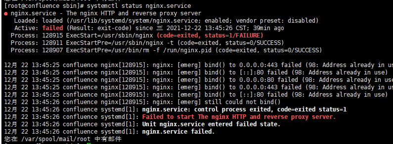

我们近期观察发现,系统中的nginx处于inactive状态,并且持续了差不多一个月了,但是并未影响我们confluence的使用,查看了下测试环境,发现测试环境中nginx处于faild状态,但是使用confluence也是正常的
我们在测试环境尝试多种办法启动nginx均未成功,想了解
1.这是否是正常的情况,是否会影响confluence的使用
2.如何解决这个问题呢

Hi @Arno Chen
Apologies I couldn't understand description.
By looking at screenshots I figured out that nginx config file has port (80,443). Error says "Address already in use" which means are there any other applications or process on the server using these ports ?
Try restarting nginx services.

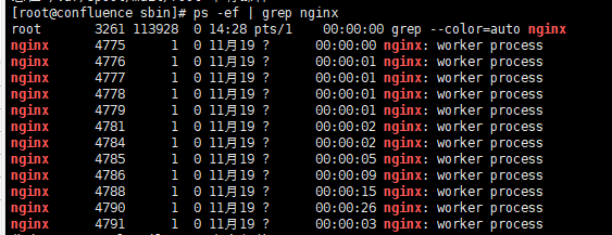

我们目前情况是,nginx显示状态不正确,但是confluence并未出现异常,我们尝试在/sbin目录下启动/重启nginx,均显示端口被占用,启动失败
使用systemctl restart nginx.service 提示启动失败
这个问题是否会影响后续confluence的使用呢

Confluence services wont be affected by nginx services. But Confluence will be available only on IP URL rather than DNS url until you figure where those ports are used and fix.
if possible can you share the contents of nginx conf file. Have you configured the file as per this link ? https://confluence.atlassian.com/doc/running-confluence-behind-nginx-with-ssl-858772080.html
