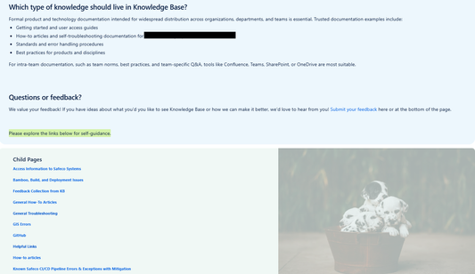

The "panel" macro of legacy Confluence is kind of replaced by macro "background" which is by Mosaic. It allows you to add custom colors or images as the background for sections of a Confluence page
Example: 2 Background macros in different colors. Below one with links and photo
You can also refer this documentation for more details.
I hope this help! 😊

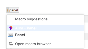

@Jason I'm not sure what you mean by panels not showing up on new pages. I've only used the new editor on cloud, and, when I create a new page and type /panel, I get the following list of panel macros to insert:
Are you not seeing this? Or maybe I've missed something in your explanation or a change announcement from Atlassian.

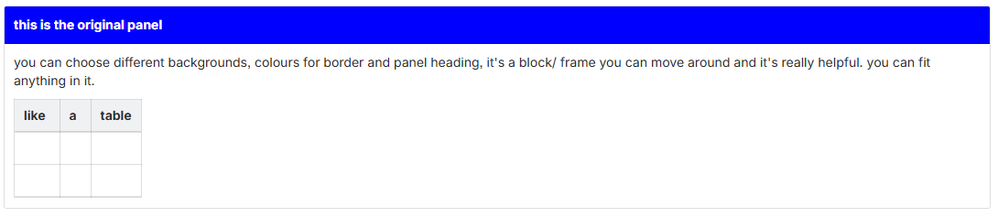

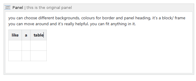

hi, this is the confluence panels i'm mentioning, they're the ones i've used way too many times!
Here's how you get it (but your page needs to be on-prem/legacy format for it to show up)
Once you have the panel you can do whatever you want inside it, including colour coding the panel so each panel can mean a different thing. they very visual and good for organising pages.filling it.pngHere's what it would look like on a page. I've used these for ten years or so, they are very versatile and when you're moving stuff around, they really helpful.
