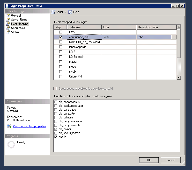

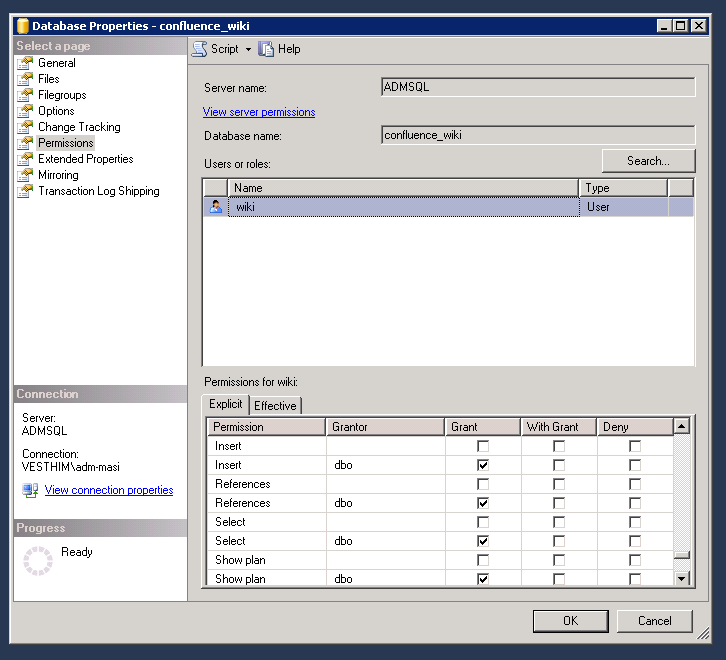

I keep getting this error:
ERROR [main] [sf.hibernate.util.JDBCExceptionReporter] logExceptions SELECT permission denied on object 'BANDANA', database 'Confluence', schema 'dbo'.
even though my db user seem to have the correct permissions to acces the and select in the db. I am trying to get confluence working on a ms sql.
4OVXoddAFoSzZ9
If i log into the database with the user i have created for it (wiki) i can select just fine on the database, so what am i missing?

In the setup wizard, in the database connection URL, please make sure the database name is confluence_wiki, Confluence defaults to the database name "confluence" and it looks like that's the database referred to in the error message you posted:
It sounds like you already saw: Database Setup for SQL Server but please double check the steps if the issue doesn't turn out to be the database name.
gravballe
July 28, 2017
I have the connection string as:
jdbc:jtds:sqlserver://admsql:1433/confluence_wiki
so that part should be correct, also it has created the database content just fine, its just after it creates everything it then fails?
