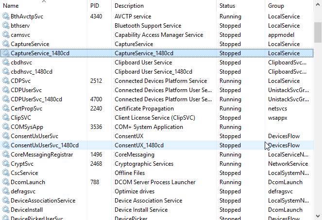

Actually, I installed Confluence as a service, but I do not see it under Services.

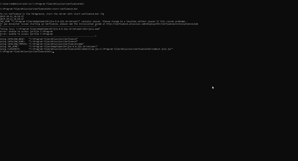

If they have nothing being written at all, then the service is completely unable to start.  The next test would be a command line shell, changing directory to <confluence install>/bin and issuing "start-confluence.bat" to see what that does.

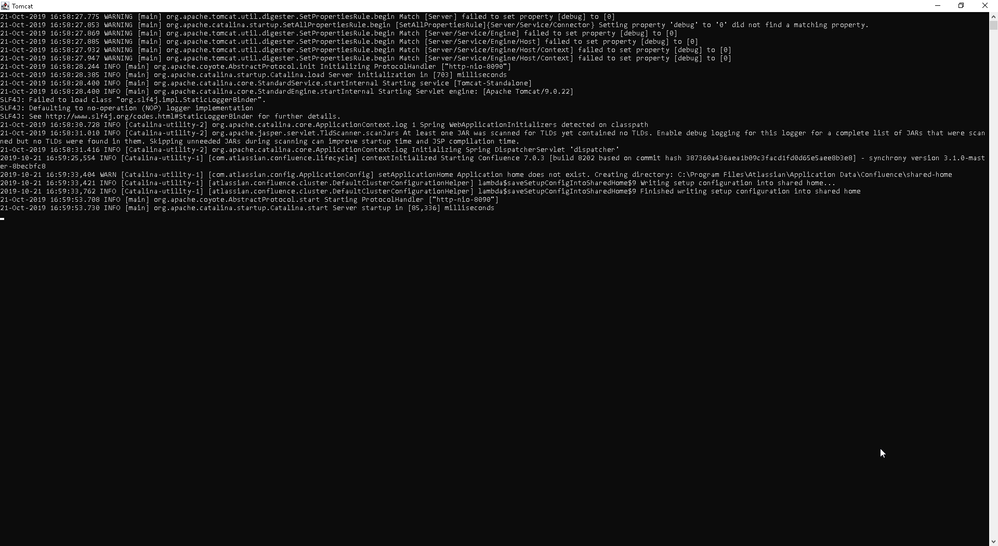

I ran the start-confluence.bat over the cmd and Confluence was installed.
