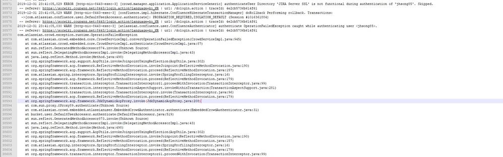

@송재훈 From the log you shared https://community.atlassian.com/t5/image/serverpage/image-id/77511i59CE36A0AFD51E26/image-size/large?v=1.0&px=999
Can you double check if you can still log in via your JIRA server? The exception shows you "Directory 'JIRA Server SSL' is not functional"

@송재훈   Could you please show the logs in  <Confluence_home_directory>/logs/  ?  so  that  we could see clearly what the error is

What is means?
2019-12-31 23:41:05,029 ERROR [http-nio-8443-exec-3] [crowd.manager.application.ApplicationServiceGeneric] authenticateUser Directory 'JIRA Server SSL' is not functional during authentication of 'xxxxxxxx'. Skipped.
