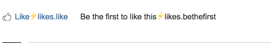

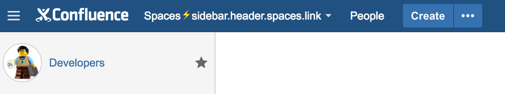

Hi.
I've do, some time ago, a translation check using the "i18ntranslate=on" parameter. Then after using "i18ntranslate=off" the UI is messed up.
Some labels are shown again with the i18n label, like "sidebar.header.spaces.link" or "like.bethefirst" in the bottom of the page.
How I can remove completely the i18n labels from my user profile?

Can you let us know what version of Confluence you're using to replicate the issue, and if you have any screenshots you can send that show the behavior, it will also help.

Pynlab SRL
October 27, 2017
Confluence 6.4.0
Schermata 2017-10-27 alle 13.36.02.pngSchermata 2017-10-27 alle 13.30.14 (2).png
SMS
October 27, 2017
Hi Emanuele,
I just tested this, and I did run into a similar issue. All the labels disappeared except the sidebar.header.spaces.link and the ones on the UPM (Plugin Manager).
But then, for some reason, once I noticed I had a UPM update and then refreshed Confluence as it requested at the end of that, the labels went away.
Do you currently have an updates you can try in UPM or perhaps flushing the cache in Confluence? Does it make a difference if you add the i18ntranslate=off to the end of the primary URL or the current page you are on?

SMS
October 27, 2017
Emanuele-
Apologies! I was able to replicate it again, and now it's stuck, and none of the above works this time.
I'm looking to see now if I can report this as a bug and also how we can turn off the labels now.
I will let you know what I find out.
Kind Regards,
Shannon
