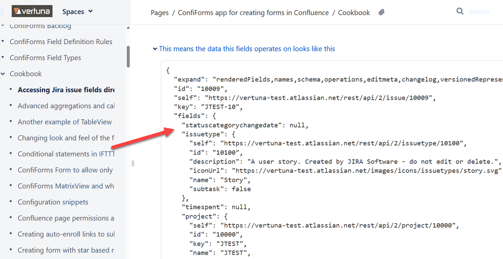

Well, there is a very clear instruction of HOW to get the JSON structure that is getting returned for the Jira issue

well, I did follow those instructions, but I am not getting any data similar to what you have in the article. If I search for my custom field in reference, yes, I find it, but I don't see any JSON like structure. Is there another way you can help me here? again, my TableView field configurations are working correctly with other Custom Fields, the only one not working is this Cascading field type.

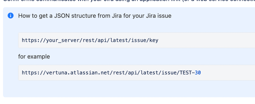

OK, what have you "followed"? have opened the URL in a browser (the format you can see above and on the earlier linked page)?

yes, that is what I did, but with my server, and my issuetype Jira Key

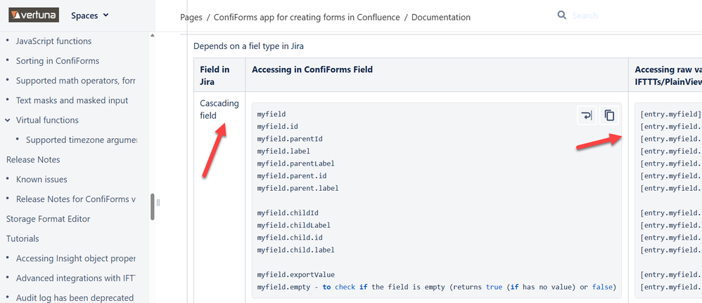

I am not sure what to send you, so you can help me. Also, you do have information about Cascading fields in a Venture article, but I have tried many combinations and none is working:
