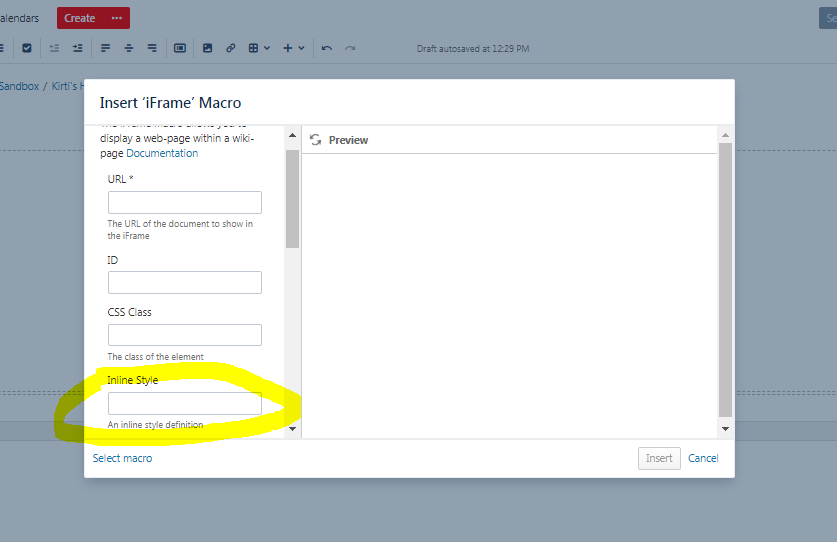

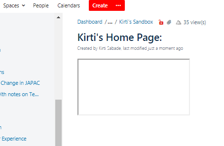

When i paste your sample code in <iframe> this what i get.
DPKJ
August 22, 2019
Better use inline styling. Try that also.
Iframe uses changes in confluence from version to version.

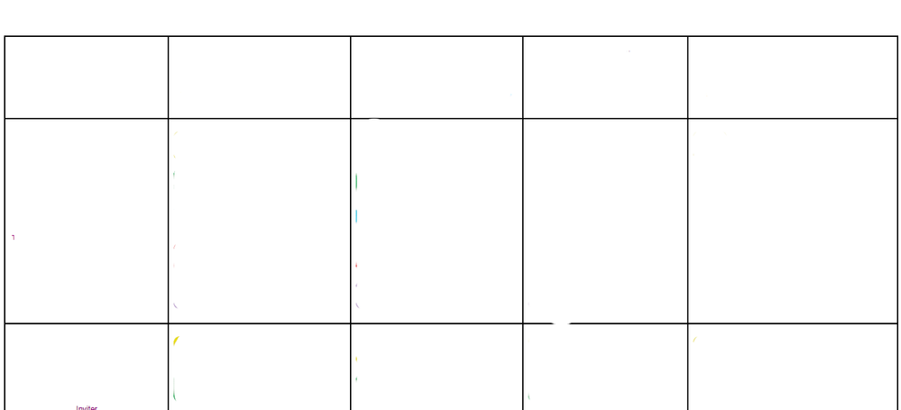

Kirti sabade
August 23, 2019
Its looking like this,
Whats the ideal way to implement this,

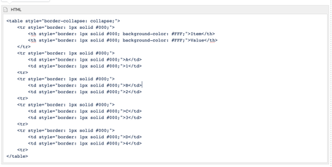

So I have tried is my self, I have added this code to HTML macro
Which produces this output

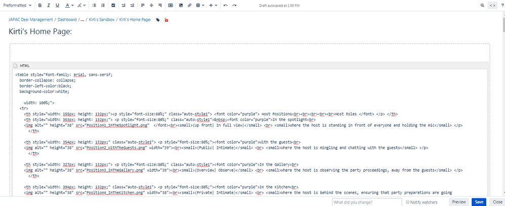

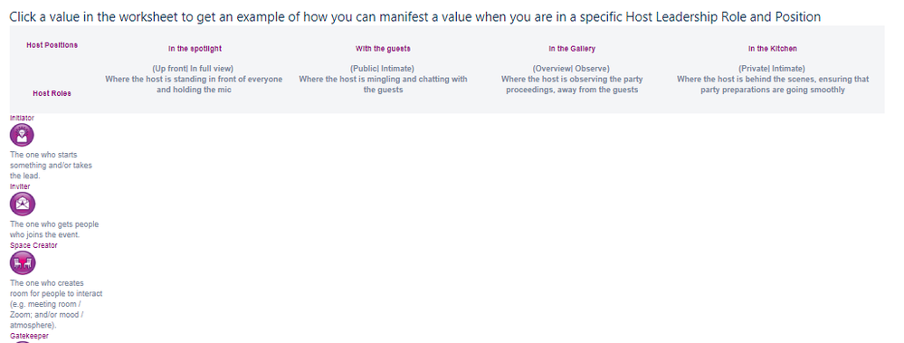

Kirti sabade
August 23, 2019
Here is how my code looks. there are tiny images on every row and column.
Kirti sabade
August 23, 2019
Never mind, Guess what?? It worked!! Thank you so much sir! I owe you so much..
