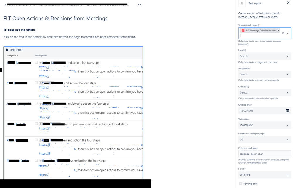

Fi Gordon
August 1, 2023
@Diego  This is still an issue.   Below you can see the redacted task report from our confluence site, showing it's not sorting by assignee.  Any chance you can fix the field so it sorts  by name and not an ID for assignee?

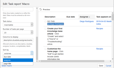

Diego
October 25, 2019
Hey, @Sukh ! Great to have you here in our community.
I understand that you need to order the list of tasks in the Task Report macro. I tried selecting the Sort by option and then selected assignee and the value to be ordered. It worked in all my browsers (Chrome, Firefox, and Edge).

Sukh
October 28, 2019
Hi @Diego
The issue we have got is, the assignee name is some kind of key. For example James on the jpg is 557058:b375bb06
So no matter whether you sort it in the editor or the form asc/desc it just doesn't sort it normally.
