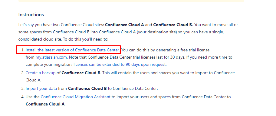

I am using this steps:
From this link
https://support.atlassian.com/confluence-cloud/docs/merge-multiple-confluence-cloud-sites/

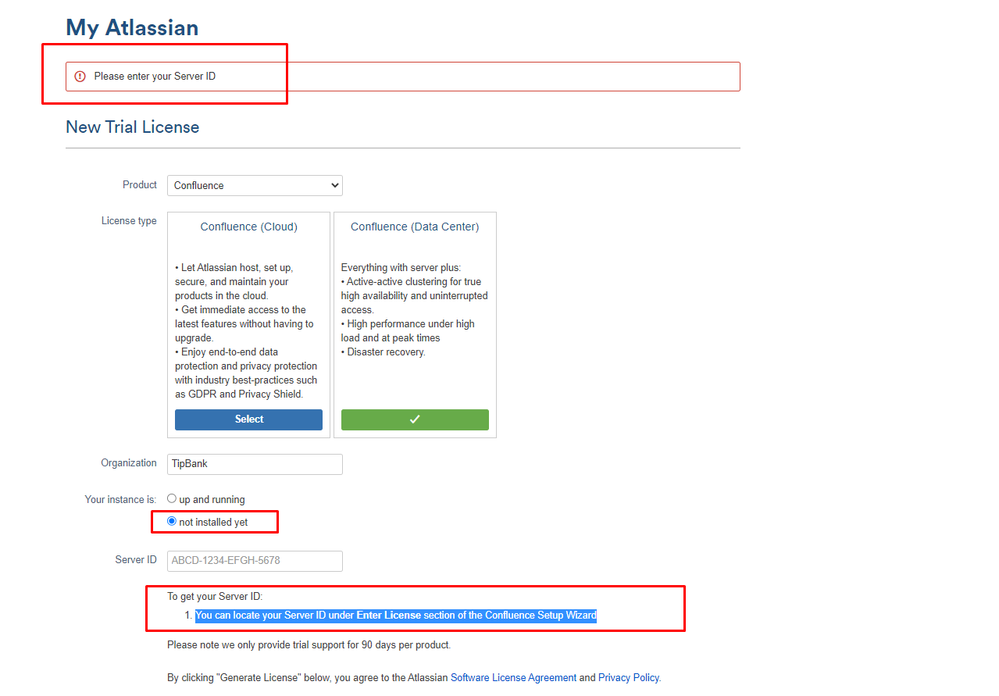

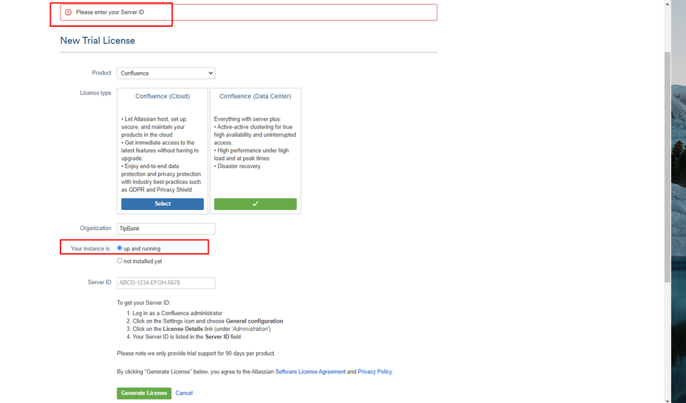

And when i triy install the confluence data center for this migration, its ask me for server ID

When installing the DC version don't choose that your instance is not up and running yet. That should do the trick.
Yes, that's why I told you NOT to choose that. Choose "not installed yet"
Ah! I've made a minor typo there I got you all confused. Sorry :)
No problems friend.

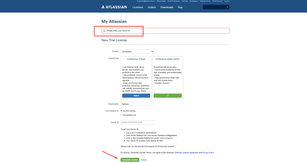

But if choose the option "not installed yeat" i receive the same message.

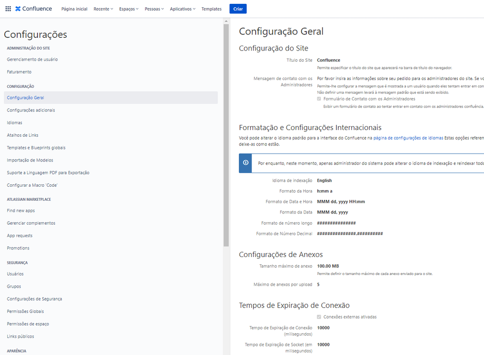

If you are Confluence Admin you can find the Server ID in General configuration, click on the License Details link (under 'Administration') The Server ID is listed in the Server ID field
Hi tam, thanks for your help.
you can read the comment I left above..
I tried to locate the path you indicated but there is no such option. I am admin of both sites
